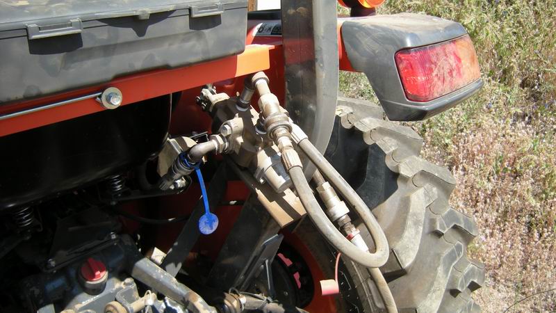

Kubota hydraulics generally are open center - the pump is always pumping, and the oil is always flowing. When you use a lever, it diverts the oil to the proper cylinder, and allows return flow from that cylinder. If you use closed center you block the flow of oil, and fairly quickly destroy your pump.
I had my dealer do my initial remote setup - it was a poor job. He took the hose from the FEL valve to the return manifold of the tractor and replaced it with a longer one that reached the back end. He mounted a quick disconnect there, and probably used the first hose to run back to the manifold. $500. You can do better. The QD set costs about $35, and the long hose maybe $25? Engineering must be expensive.
Your problem is mostly finding a place to mount the valve. There is surprisingly little space, when you try to mount a big valve. I couldn't find a small one.
This is what he gave me, and what I did with it. A dual valve would seem HUGE!!
