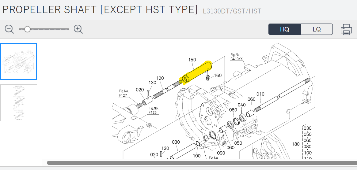

I think there is a seal and when it gives up the grease goes into the shield that covers the front PTO (should be propeller shaft) shaft.
