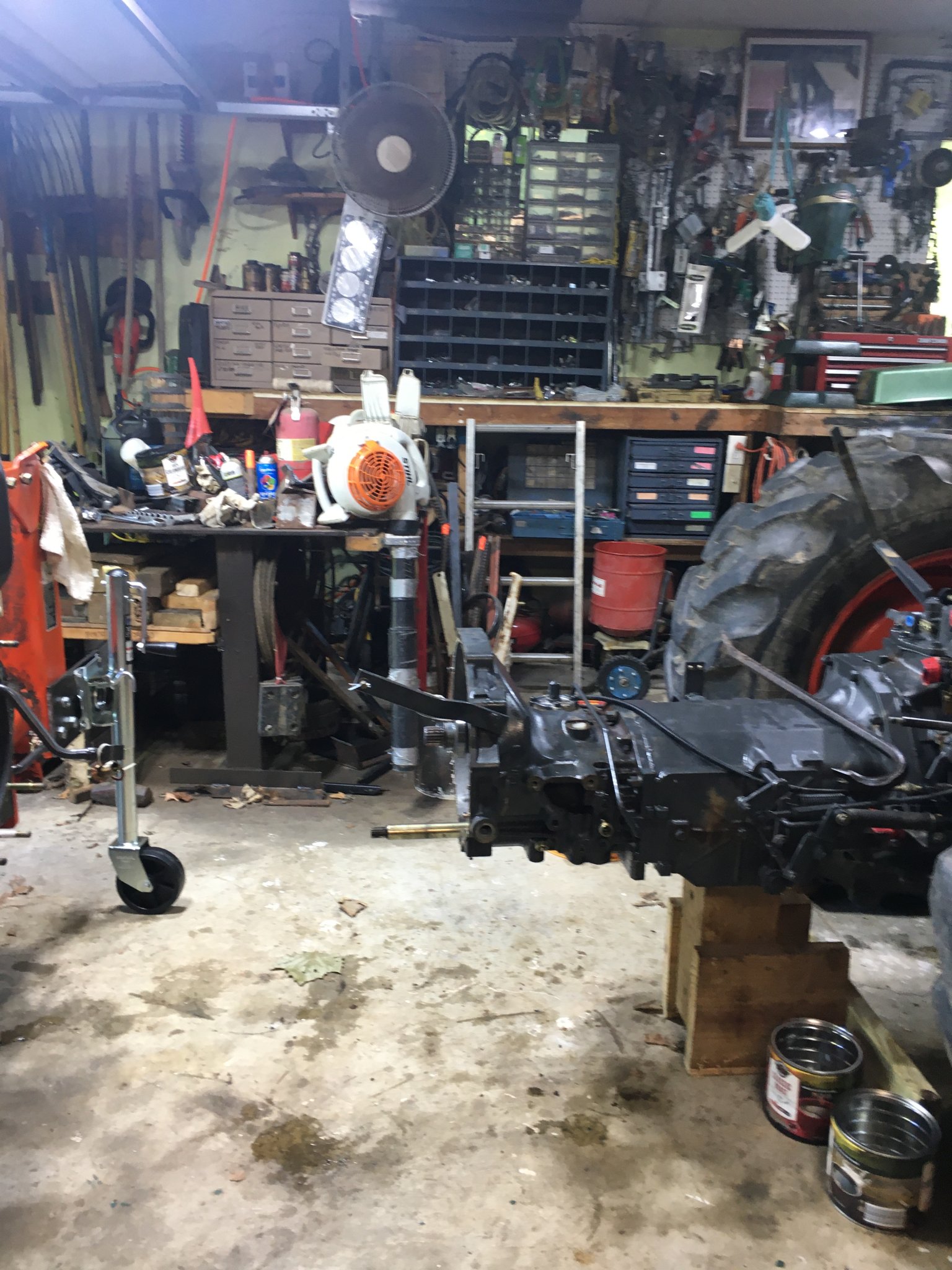

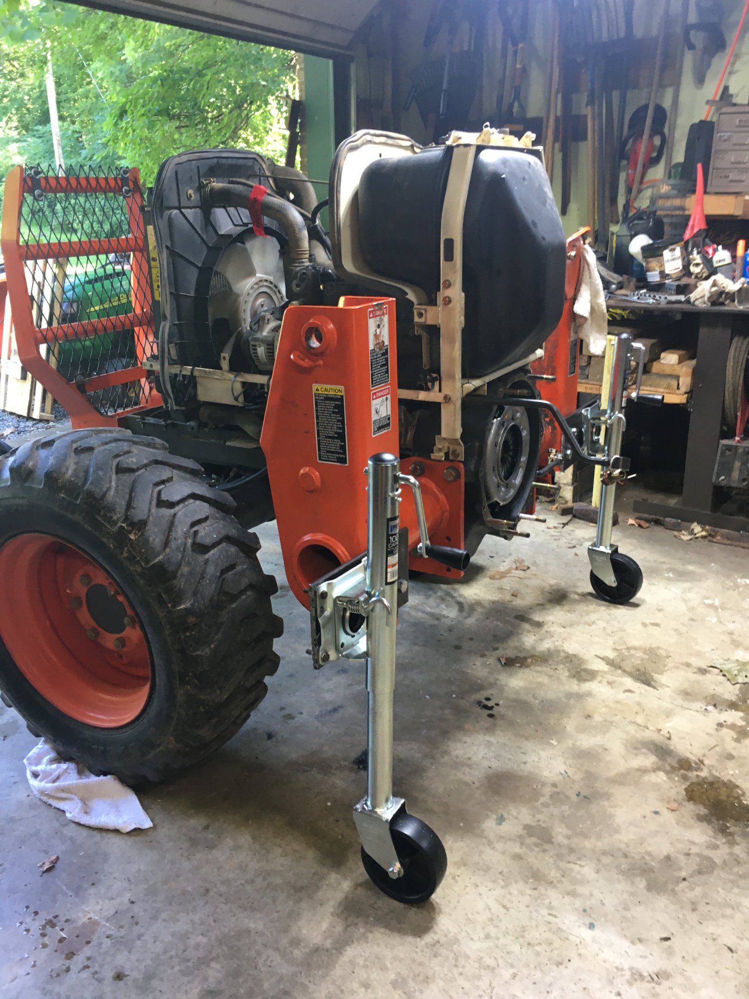

Had same issue my l3130 HST 1100 hr was the HST unit / Pull filters & cut open will give you answer brass or steel / if you have steel you will have brass also / will post some pictures next post / ended up buying a used HST on line.

I have the original HST / The slippers are chewed up a bit/ steel slipper guide ring broke in pieces / you have to buy the slipper ,plungers, swash plate assembly from kubota $11k /used hst like $6,500 dont rember exact. / kept it because it still worked just boged down in high & mid range on hills low & rev. ok / if filters are clean might be relife vavle in HST there are 2 of them / will take some pictures out of repair manual of parts // if you know how to pm me will give phone # we can talk
