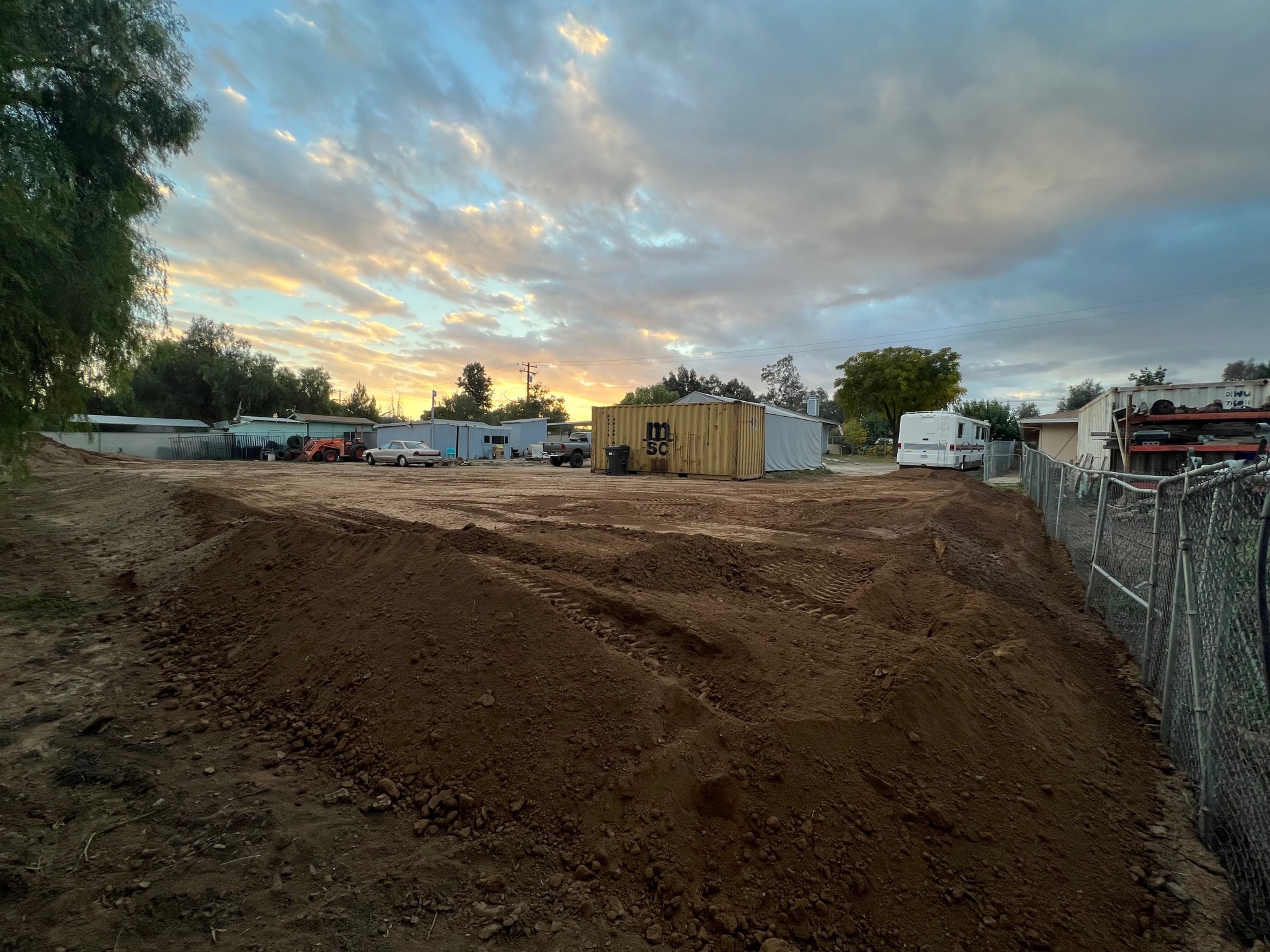

I have an L305dt that I've put about 40 hours in since buying it in April. I paid $12k for the tractor with box blade and L1720 FEL and a brush hog. I filled the rear tires with water and so far, the tractor has served me very well. Actually, the tractor has changed my life for the better, having accomplished many projects around the property that otherwise wouldn't/couldn't have been completed.

Photos with the 305 in them, because everyone loves photos!
