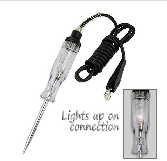

Having a 12 volt test light is useful so you can easily monitor when the GP's are being powered.
