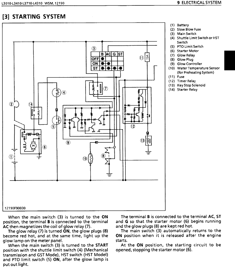

I would first double check the B terminal on the ignition switch for voltage. If none there Then go back and double check the voltage at the slow blow or JCase fuse. You need to back probe the connector and make certain you have voltage on the wire on the load side of the fuse.
If you have battery voltage at the B terminal of the switch then check for voltage at the AC terminal in the on position. Then check at the ST terminal when at start position.
Do this before trying to jump anything.
See info below..
