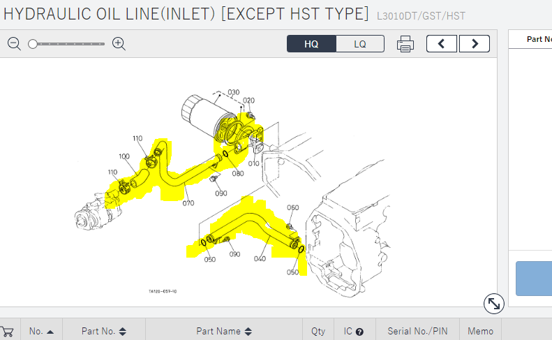

First check all of the suction lines for any wetness like they could be leaking.
Next you'll need to follow the WSM and check pressure to the GST system, could be an issue with the steering causing the GST to lose pressure, or vice versa.
If you don't have the WSM (aka service manual) just ask.

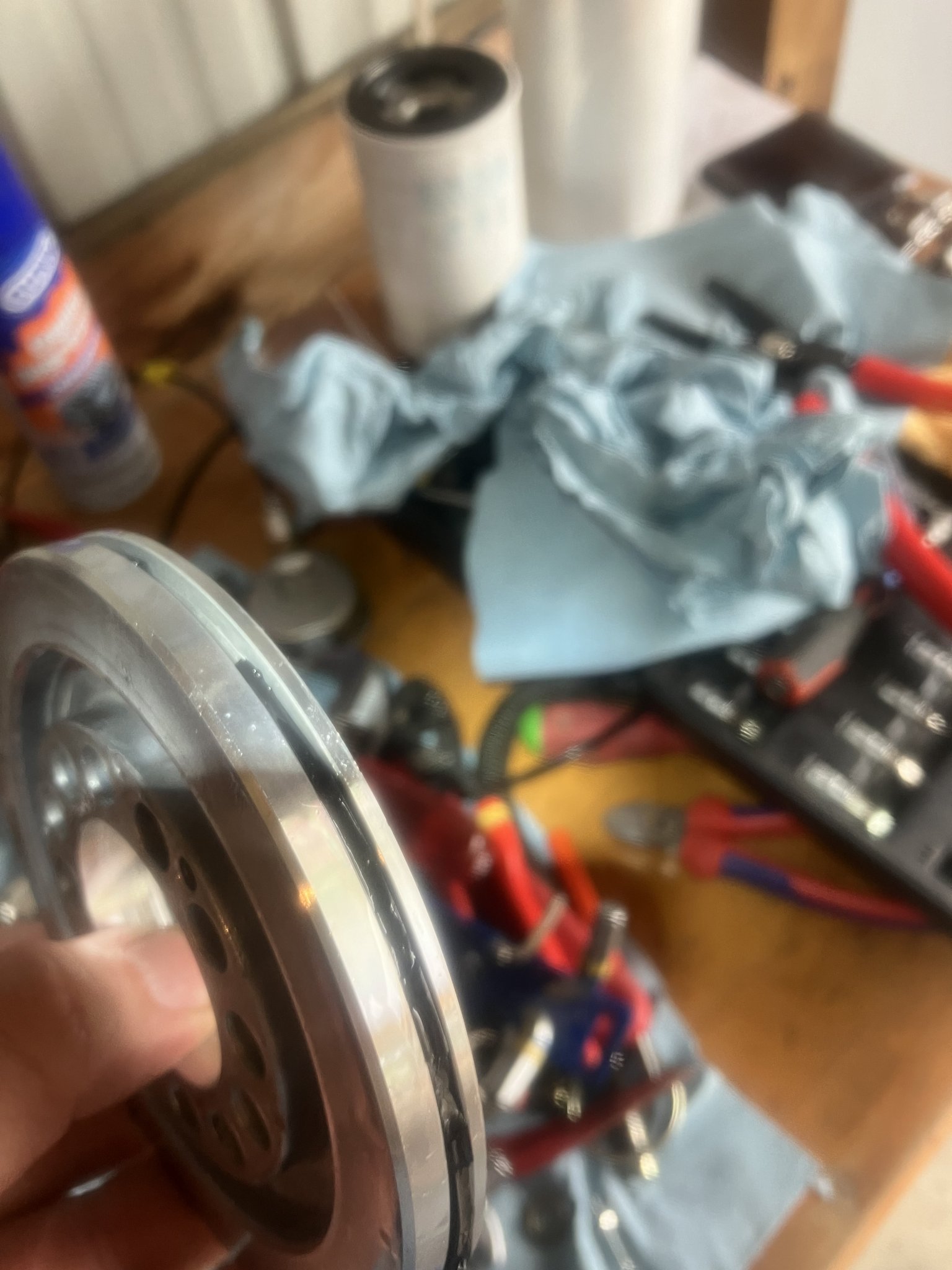

Even if nobody answered anymore. Perhaps it is interesting for some folks.
today I got my tractor fixed.
We did split it, according to the wsm.
At opening the wet clutch, we found the D Ring from the clutch piston severe damaged. After replacing and closing again, pressures were good , it runs great again.
Sorry I did miss your June 19th post or I would have told you the same thing you found out.
