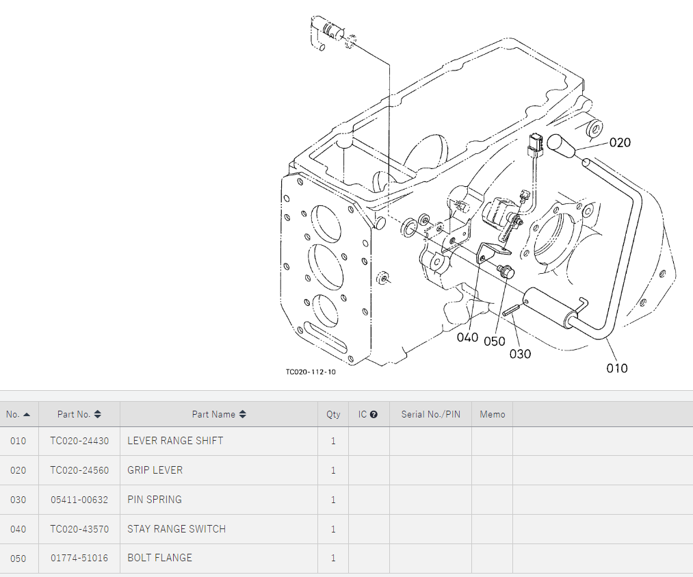

I recently purchased this L3000. From a individual . And not knowing much about them, might have been a Big mistake!
Finely figured out what the lever on the left did. It’s the Hi-Lo gear shift lever, & it doesn’t Work! It just moves back & forth very easily, with no resistance. And the Tractor drives the same. And while driving, you can move the lever back & forth.
So apparently it’s not connected inside or broken!
How do I fix it? Or do I have to take it to a dealer?
Thanks for any & all advice.
kartman
Apr 8, 2015
11
I just checked # 30 the pin is visible. But I’ll knock it out tomorrow to see if it’s sheared. I really hope that’s the problem!
Also where can I find the Illustrated parts list, is it a book?
34,712
9,975
I checked, the pin is there & not sheared!
do you think that I can get to it from the top of the rear end?
Or does the tractor have to be split?
You can see it from the top, if you can fix it or not is another question.
I would start with that and see where it gets you.
