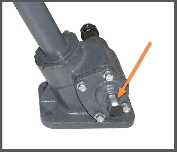

I have the cowl and gas tank off for fuel issue, so I have a clear access to steering gearbox.
The play seems before the Pittman arm - thus in the steering column/box.
Does anyone know if there is any “adjustment” screw? I do see a square headed bolt!?

This is the adjustment point.
Remove the rubber bung, loosen (don't remove) the nut.
Inside the nut is a slotted screw head. Adjust the screw, then tighent the nut, and put the bung back.
Turning the screw one way will make things worse, then other way will make it better.
Howvere there are other things inside there that can wear out.
You may not be able to adjust out all the wear.
