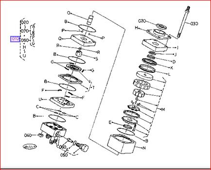

I noticed after working today that there is Hydraulic Fluid leaking down the steering column form under the steering wheel.
What is the common failure here? It seems that I have read a thread on this before (maybe not this forum) but I could not find it. Why would there be fluid in the column? I am not sure I understand how this steering system works.
Either way, I need to diagnose this and fix the leak. Still have a lot of work to do with this machine.
Thanks

That model either has a PS box, or Hydrostatic steering.
Sounds like you have full hydrostatic steering, The controller is under/ behind the column.
Power steering the gear box is mounted under / in front of the motor.
But before I possibly lead you astray please provide the model#
Or a picture of the front of the front axle (steering rods or steering cylinder), either will confirm the set up. ;)

L2950DT GST
I am pretty sure it is s hydrostatic. I looked at parts diagrams after I posted last night.
I am guessing I have a shaft seal leaking in the top of the box. What are the tips, tricks to fixing this?
33,010
8,459
If you need to get into the hydrostatic steering controller, read the section on it in the manual several times, and Caution that controller is VERY expensive ($1434.45) and one piece out of place and it will not work, and it has several of those pieces.
I don't think changing one shaft seal will fix it, most of the time if they leak you need to put a complete rebuild kit in them.
#20 is just a dust seal, no oil or pressure, so if that's where it's leaking fluid from it needs a rebuild kit.
If you note the internal parts are lettered and not numbered, that is because you have to buy them in kit form, no individual part #'s.
