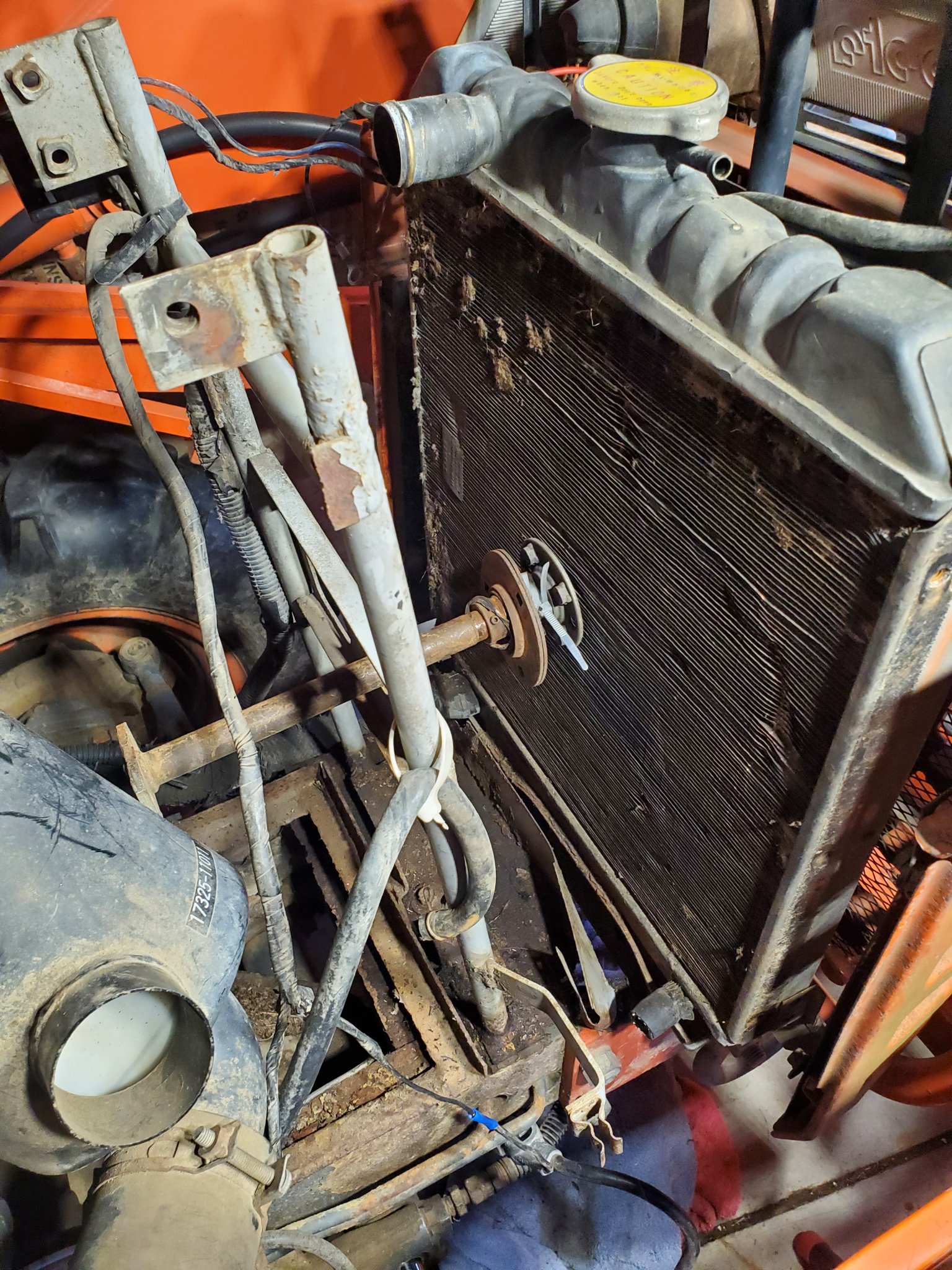

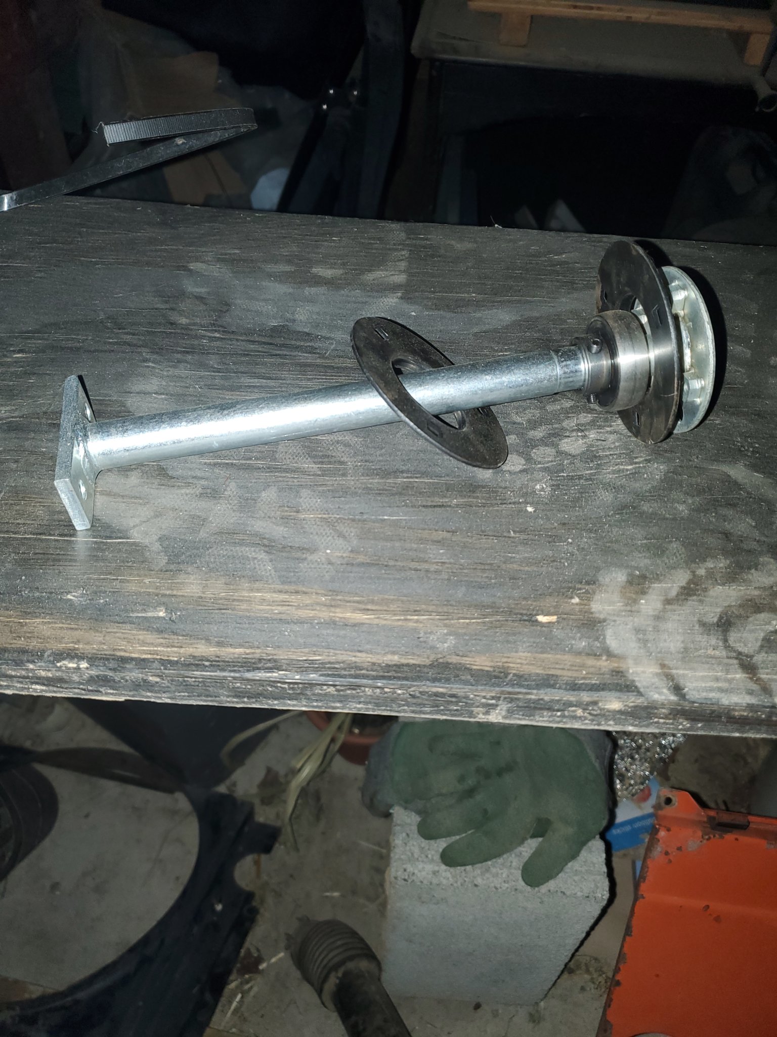

I cannot get the old fan shaft out....there does not seem to be enough room to pull it out. I cannot figure out how to remove the radiator to get more room. Does anybody know the best way to remove the old fan shaft?

The radiator is probably bolted to the frame and there are some castle nuts to remove and possibly some rubber isolators. Then the radiator will lift up and out.
At least that’s how it works on my L185
