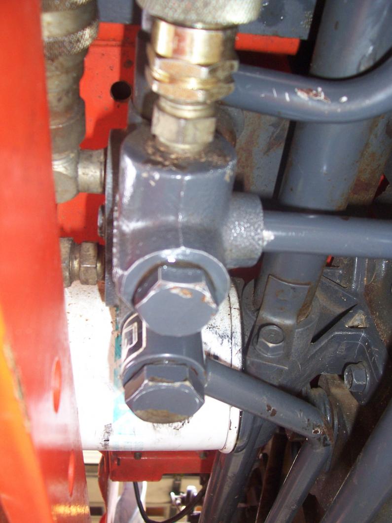

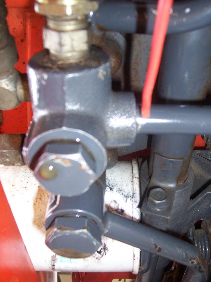

My tractor has a leak on this manifold. I don't know what it is or does and the line looks like it is pressed in. So how do I tighten/fix this.
The red wire is pointing to the leak.

Skip, it almost looks like it is leaking from the front nut I see and running back.
just a thought but I would wrap a rag around the nut and run it a bit and see if it still shows where your pointing.

Is the pipe where it's leaking short and strait?
If it is there is an O-ring on each end, pull the block and replace the O-rings. ;)
Note: have a catch pan at the ready I don't think it will dump fluid when you remove the block, but that than you or the floor covered in fluid!
