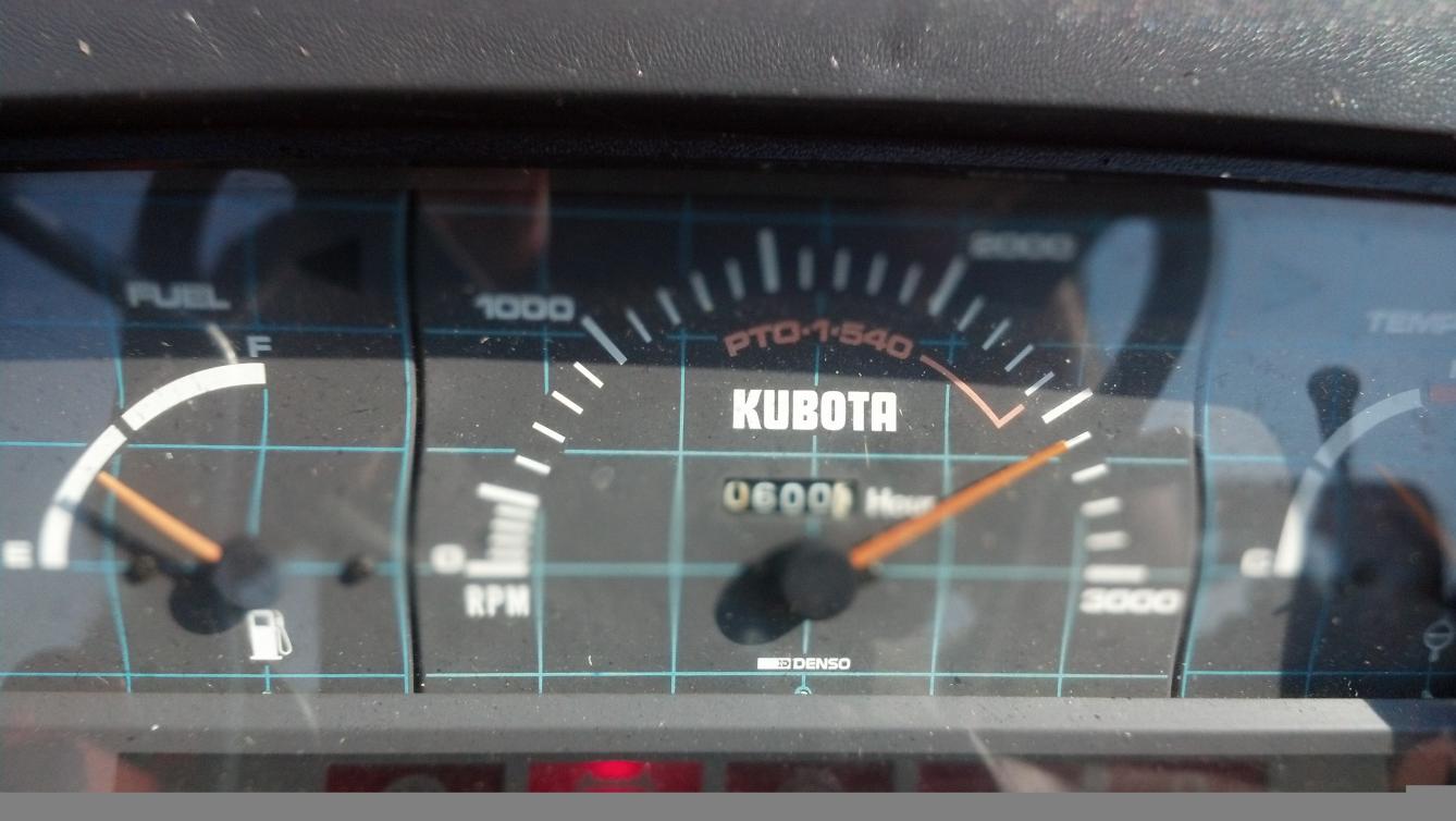

Where dos your temp gauge read when mowing? I run a 5' L&S Line bush hog with my L2850 ... which I think is sized about right for the equipment. I was a little surprised when the temp guage climbed to a little more than halfway between the 1st "notch" (operating temp?) and the 2nd "notch" (red/overheat). It never climbed much higher ... but that seemed a little hight.
Conditions were:
* thick pasture (chest high)
* 85degrees +/-
* worked the tractor for a couple of hours before it climbed up
* did chase a few rats for fun ...
Is it normal to read that high?
Thanks for your input!
JT
BTW ...just hit 600hrs during the day! Pic shows the 600hr mark ... about 30 min later the temp gauge started creeping up a bit.

Seems about right. I know my 3010 runs just about dead center in the middle in this heat (at least it did last weekend). Once it hits what I call 3/4 it is time to pull it into some shade and clear the seeds/weeds/dirt out of the radiator screen.
In looking at your pic, I wouldn't let it get to the next "notch" before I cleaned the radiator screen. My gauge displays differently, but to convert to yours I would say the temp shown is about where mine holds while bushogging in this heat with a cleared radiator.
