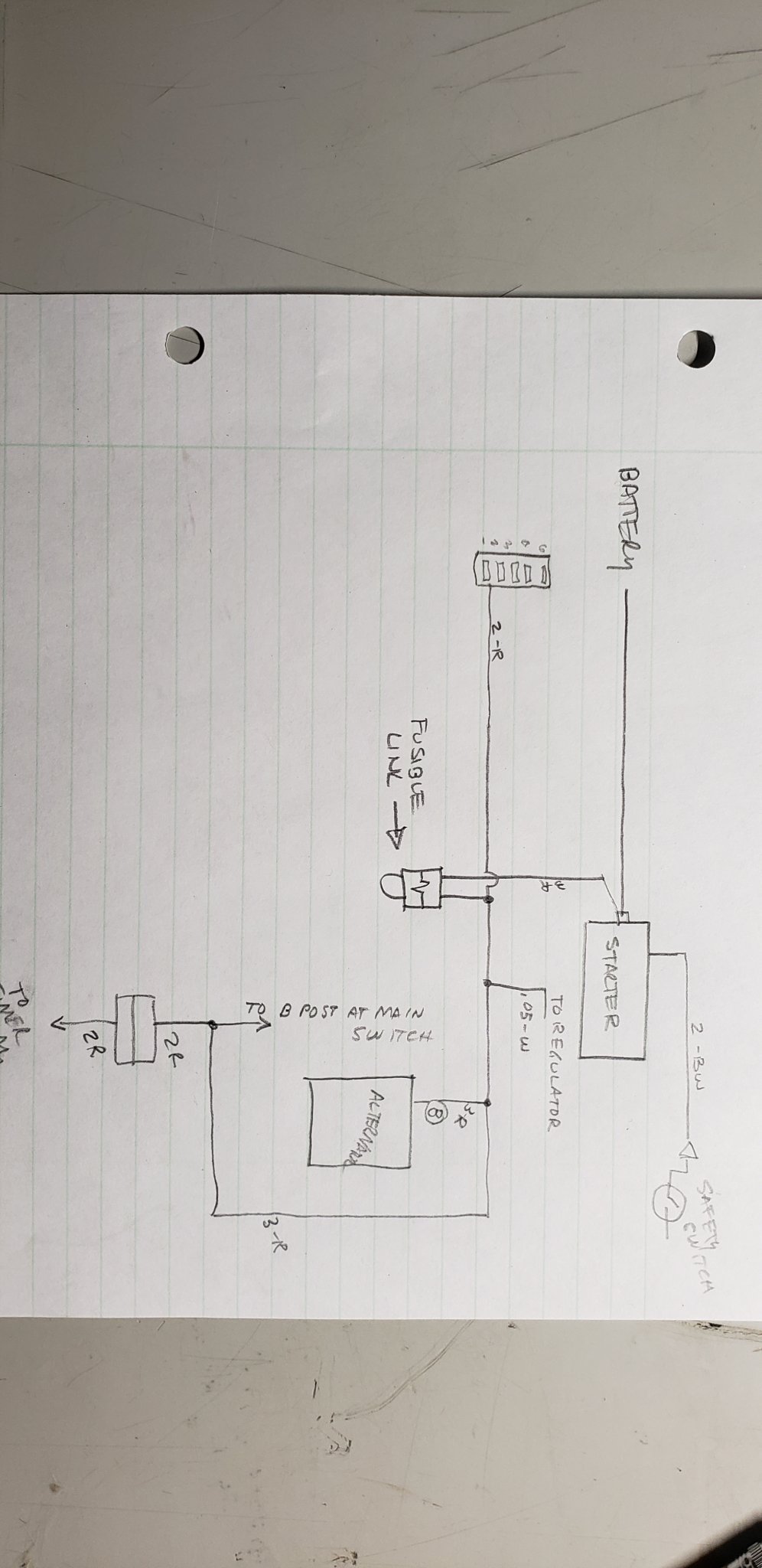

Good morning folks, new member here. Recently got an L2850DT for a project after I'd sold my old MF30B. I needed 4wd. Anyway, it starts great, when it starts.
Recently it's taken to not starting at all. Lights come on the dash but no sound from the starter. Only sound is a relay under the front of the fuel tank so I'm thinking it's probably the timer relay engaging.
I've tested the neutral safety switch per the WSM & it reads 1.4 ohms resistance when the switch is pressed. That should be 0 (zero) ohms so problem #1 identified. I thoroughly cleaned & brightened the battery posts, battery cable clamps, ground connection to the chassis & the negative cable, & all three lugs that bolt to the bottom of the starter.
I haven't tested the voltage & resistance of the ignition switch yet but plan to. So, with all that said, here's my question.

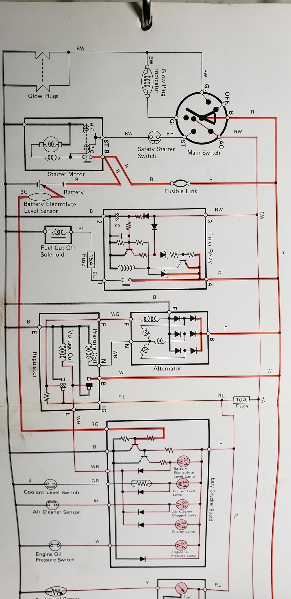

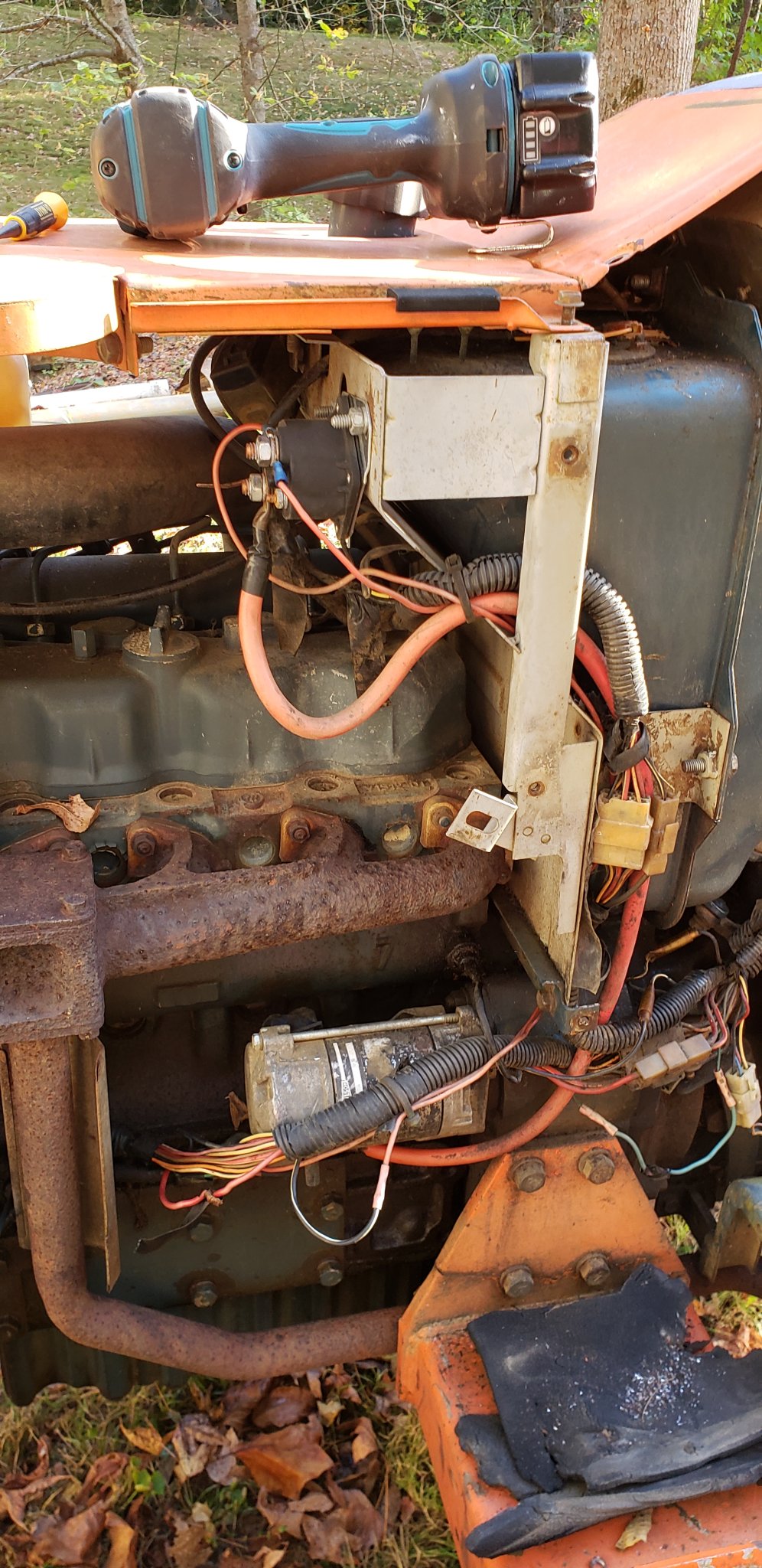

Where is the fusible link supposed to be? The wiring on this has been, well, reworked/patched/etc... from the workshop manual (WSM) it looks like the link should be immediately in front of the starter but all that's there is cable with electrical tape wrapped around it. The wiring diagram shows the link somewhere between the starter & the ignition switch. Anyone with this model (it's the later generation of serial numbers) that could post a picture or shed any light on this would be greatly appreciated. I'm trying to avoid the cost of a whole new wiring harness if I can avoid it. Thanks!

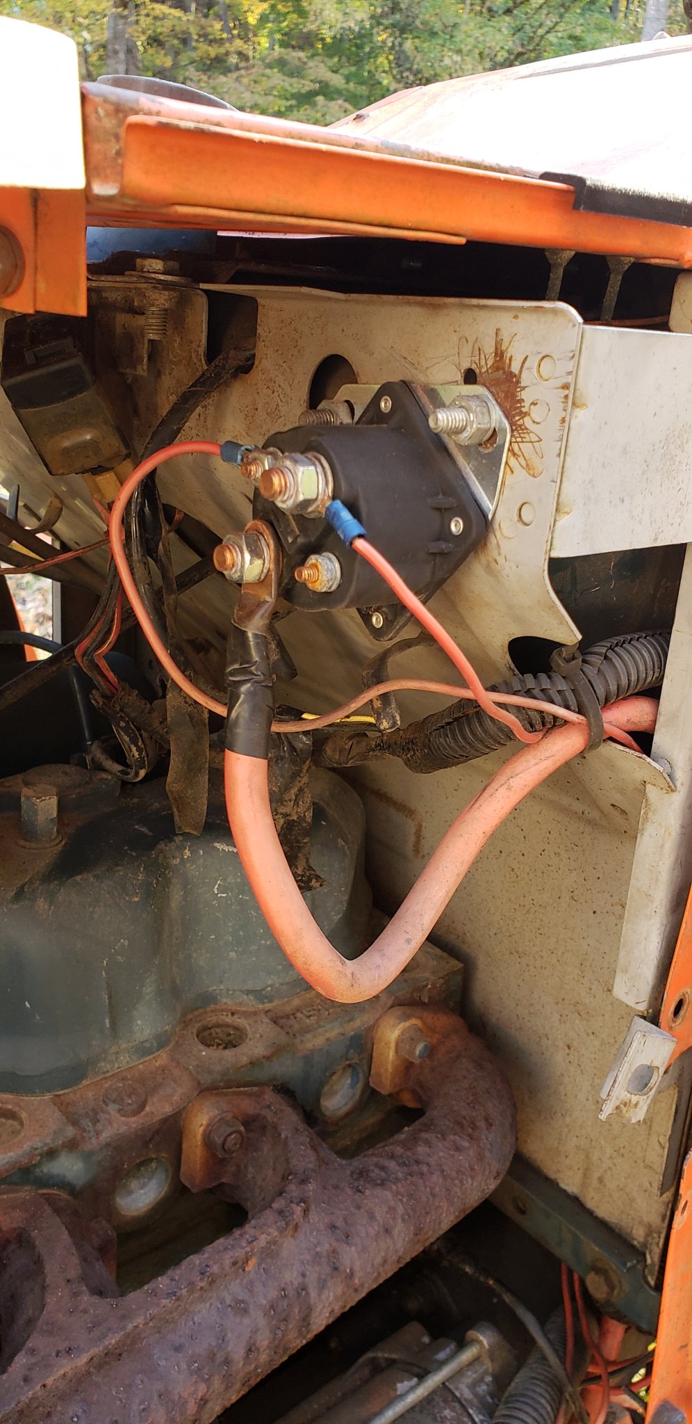

I'm guessing that it's where this red wire has been "twisted" together to "complete" the circuit.
Yep. Looks like your original fusible link was 0.5mm^2 (20ga.). You could install a 40A slo-blow fuseholder and fuse to replace it.
On the starter solenoid there is a large terminal where the + battery cable is connected.
The purpose of the fusible link is to protect the entire electrical system.
The fusible link needs to be connected to the same terminal as the battery cable. Either directly or with a short length of heavy gauge wire between the starter post and one side of the fusible link.
Open the twisted together wires and when you do everything should go dark which is what a fusible link would do.
Depending upon your local auto supply place you could buy a modern slow blow fuse. Most places have the actual fuse but not the base so getting the base is the challenge.
The wire diagram you posted shows the fusible link gauge as 0.5 and while I have not looked that up 40 amps is the typical one.

Thanks guys, seriously. I'm sure we all know this tune "I've got to fix ten things so I can fix the thing I really need to fix". I am planning on replacing the o-rings & gaskets for the injector pump delivery valves this weekend but I need it running to get it into the shop. If it was easy, everyone around do it I guess.
Anyway, I'm going back down later to confirm that the B post on the alternator goes to this twisted connection & then on to the fuse block for the position 1 fuse. Based on my single-line I've drawn to isolate this circuit that's where the fusible link is supposed to be.
So, once I'm sure that's where it goes I'll look around for the appropriate connector to reinstall and either use the factory link or a more modern slow-blow fuse (40A) as you've suggested. The local dealer has the link in stock so if I can find the mating connector I may go back to factory design.

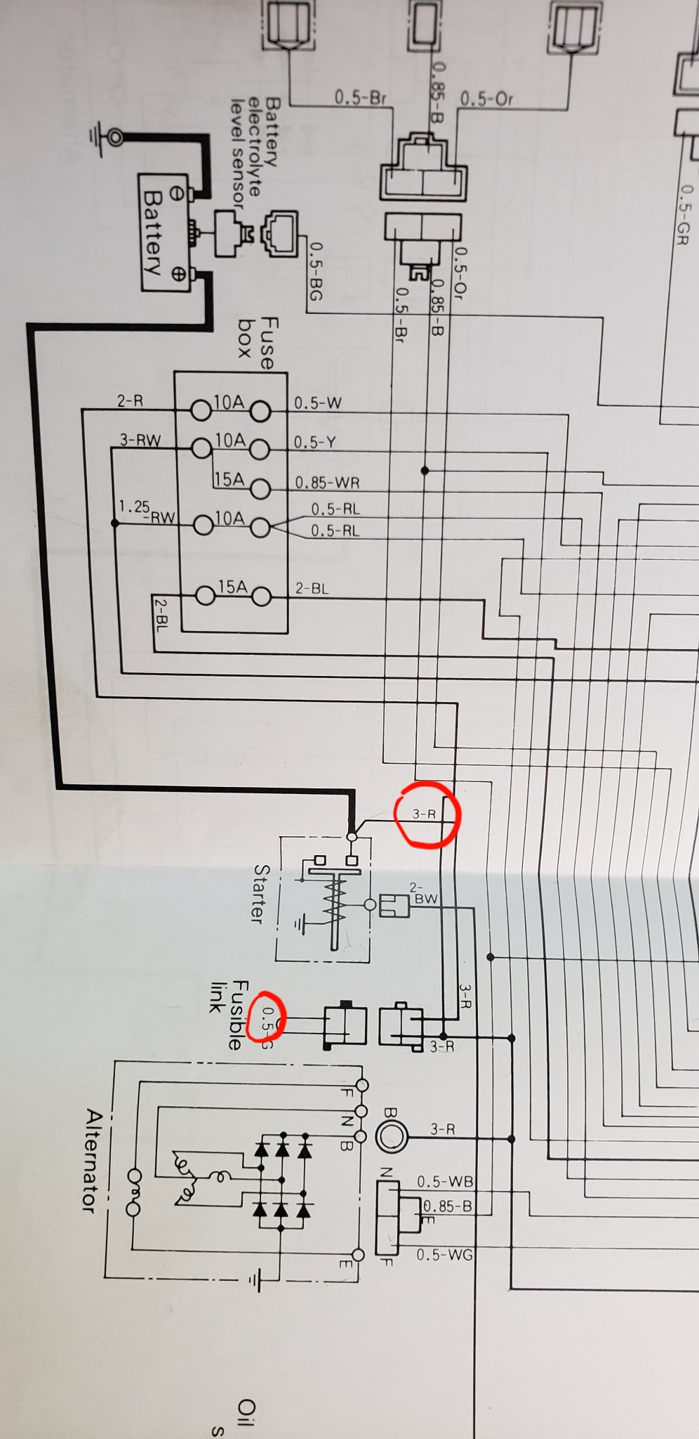

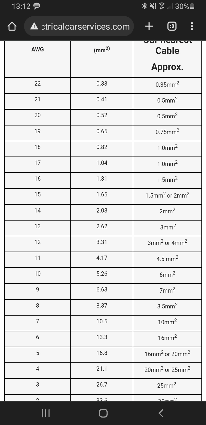

One semi-related question: do you guys know what the numbers before the wire color mean on the wiring schematic? They're too small to be amperage. I don't recall seeing that before. I've circled a couple of examples on the reattached wiring diagram.
Thanks again!

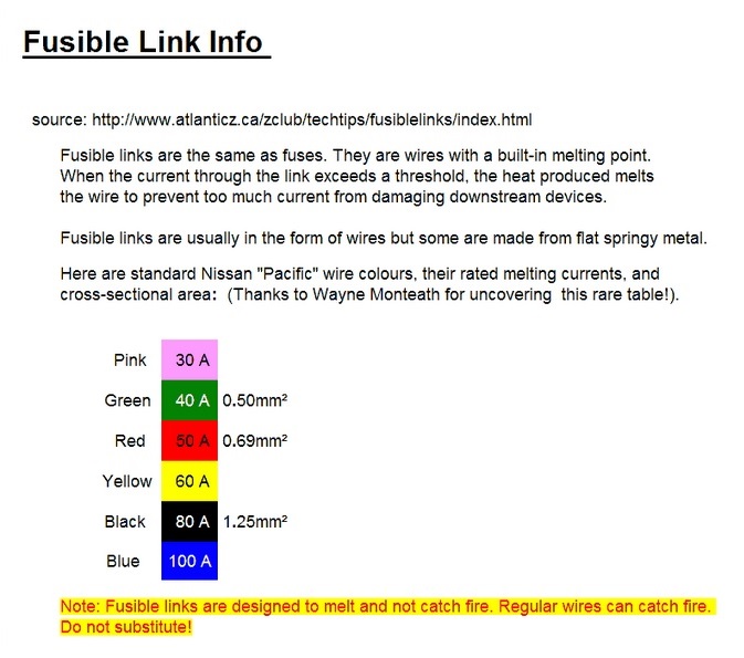

Wire cross sectional area which relates to current carrying capacity.
Look on the chart below. Green section shows 0.5mm2 which is what is on your diagram.
Dave

Yep, I'm a complete idiot. I was trying to figure out how to understand it and then your post clicked. It's a kubota so the wire gauge isn't shown as AWG but metric instead. Now I get it. The 0.5 is basically 20 ga stranded. Thanks for recalibration my head unit (ha)!

Thanks to everyone for the help. I think I've identified a big part of the problem. The previous owner intercepted the black & white wire coming from the safety switch & ran it up to a power block he installed & then brought another wire back down to attach to the spade you mentioned on the bottom of the starter. To power this "block " they ran an extension of the main positive power circuit up to the block using a heavy gauge (looks like #2 or #0) & jumped off the main lug on the starter. I have no idea why but I'm putting it back to factory spec to test if the problem (combined with the new safety switch) is resolved. I'll also use a new spade to send the signal to the starter. Of course, if this doesn't fix it it's either the wiring, the starter, or the ignition switch but the presence of this jury-rigged setup combined with the resistance reading of the switch gives me hope for resolution.

The block as you refer to it is actually a heavy duty relay often found on older Ford vehicles and also garden tractors.
John Deere came out with a relay kit to help tractors with starting difficulties as the numerous safety switches aged and developed too much resistance to trigger the starter solenoid.
It looks like the previous owner was copying this system.
Here is the John Deere literature. Many have copied there design with a cheap automotive relay. Newer tractors now have a relay to trigger the starter as part of the original design.

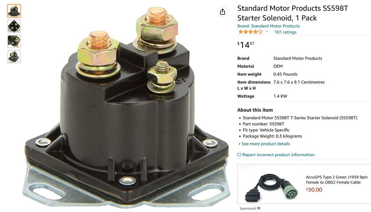

This is the type of relay now on your tractor.

Well, that certainly explains the loud relay closing sound i hear whenever the key is turned. I didn't think it would be the timer relay to the right. I will probably do some voltage drop testing to see which configuration produces a higher voltage at the solenoid connection before removing it entirely.
I thought it might be a relay with the infeed & outfeed lines. The only thing I could imagine was that maybe there had been something else attached to the machine before I got it that would need that much power. Thanks for the heads up!

Following up on this. I replaced the safety switch that was giving higher than spec resistance. Problem still exists. I'm charging & running the battery through a repair/desulfating cycle on my charger just in case. It's a 2019 battery so not that old.
In the spirit of only fixing one thing at a time to be sure that I've caught the problem, I wait for this to finish & replace before moving on.

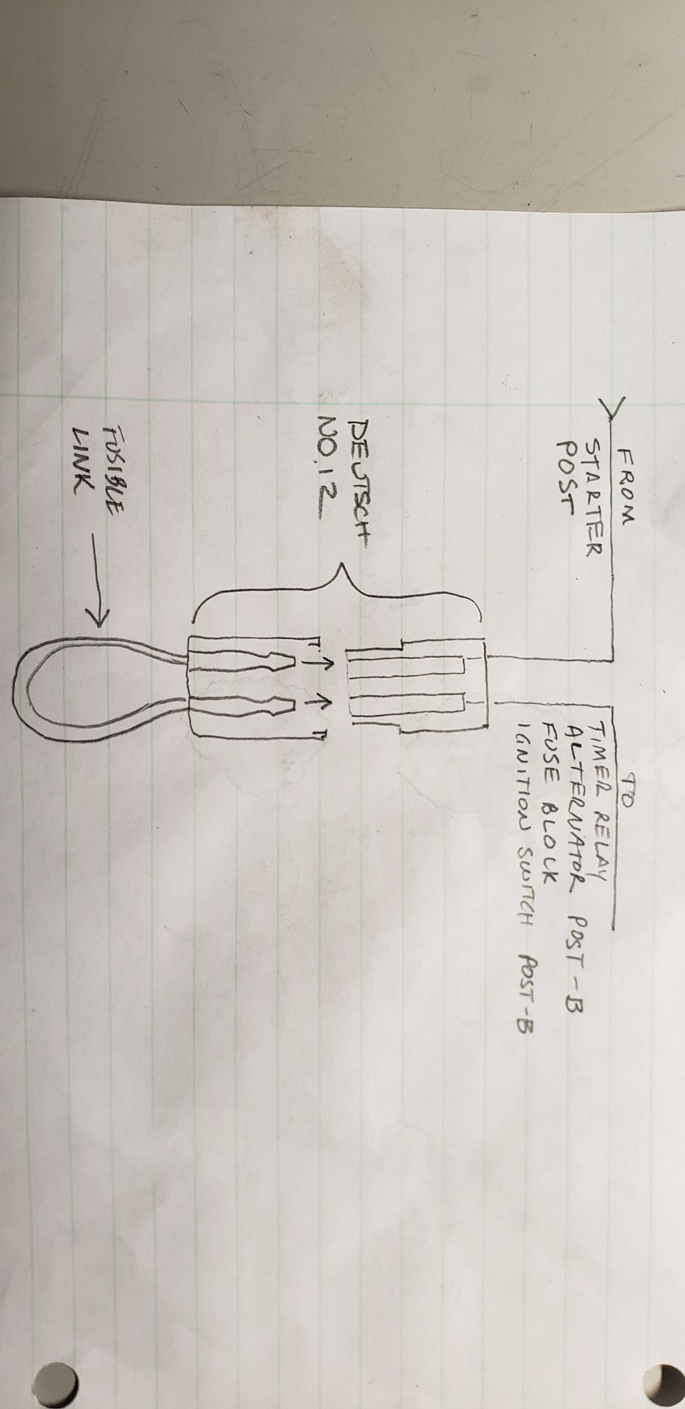

However, the mtster of the missing fusible link still persists. So I have the replacement link from kubota but the wiring harness pigtail is missing since the PO removed it.
I've removed the wire that comprises the link from the plastic housing since I have been unable to locate a matching female side. Here are my thoughts & I'd be open to all critique or advice.
Option 1: leave the male side as factory & use two individual female connectors to join this into the wiring.
Option 2: remove the brass terminals from this magic green "wire/fusible link" and install the wire into a No.12 Deutsch connector as an "in/out" loop. See attached sketch. I realize that a no. 12 connector is nominally rated for 25amps continuous but this "wire" looks smaller than a stranded AWG12 wire.
Option 3: take my lumps for the $11 fusible link & install a 40A slow-blow fuse as has already been suggested.
Thoughts or opinions?
