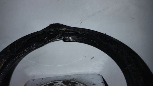

The right Kubota seal for your motor is P/N 16433-04460,
much better seal than the kumar supplied seal.
Sadly this is what the Kumar seal did after about hour of use.
I've replaced it with the Kubota seal , and it's holding perfectly.

Is that a Kubota part #? This is why I am looking for an OEM Kubota seal # based on your experience.
I looked up the rear crank seal number in the Carrier books and they show a part # of 25-37198-00 which looks like a Kubota #.
36,878
11,559
Yeppers the number I gave you is Kubota's number, I bought it from Coleman's.
Kubota part #'s are almost always XXXXX-XXXXX form. ;)
36,878
11,559
Since your using the gear case cover off of the original motor you will want that seal off of the V1702 (but in this case they are the same seal on both models) P/N 09550-00001
Check the gear case cover gasket and O-rings as there might be a slight difference (down by the oil outlets if I remember right) and you might have to get the gasket for the V1702 to match the case. ;)
