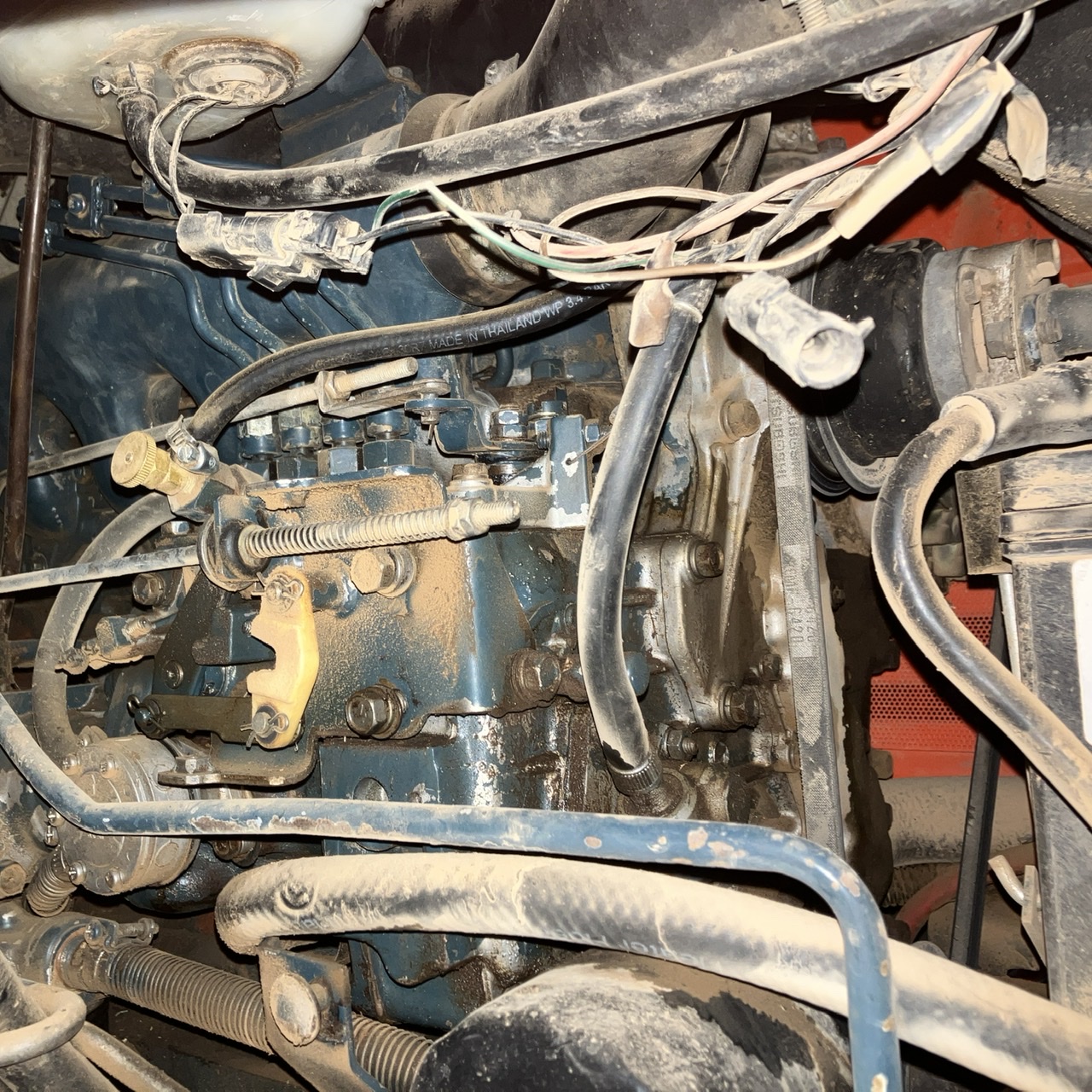

Been going through my L2850DT here and there, and have a question.
My timer relay looks pretty melted, end my easy check lights sometimes work, most times don’t.
Question is, does the timer relay serve any purpose in circuit other than controlling the shut-off solenoid? My tractor has no solenoid (removed by previous owner if it had one to begin with-see pic).
I ok shutting off with the stop rod, but am curious if having it removed, or my timer relay being hinky is affecting the operation of other items in console?

I did tighten up the two obviously loose bolts on side of injector in pic.

No the timer relay has no bearing on your easy checker system.
