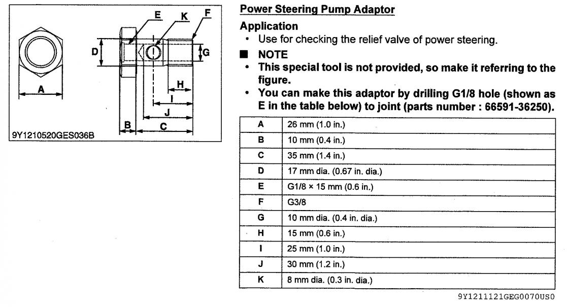

Has anyone made this adapter? I assume it would be thread for an 1/8" Female Pipe Thread.
I'll have to check about hose pressure spec, but thinking of using a grease gun hose.

Yes you would get a new banjo bolt and drill the end and tap it for 1/8", and yes a grease gun hose is perfect for this, just make sure it says 10'000 PSI right on the hose.

Since my post, I have found the banjo bolt identified for fabrication is the same banjo bolt used on the pump. My plan is to use the existing pump bolt then, either leave the gauge installed or remove it and install a plug for future testing.
