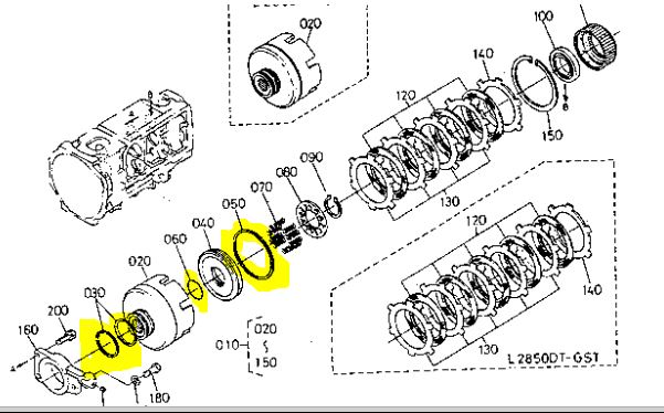

Where is the insides of the clutch drum and the seals?
That's the part that will be bad!
You need to break the rest of the clutch apart.
The 2 feed seals (30) have very tight tolerances.
The O-ring (60) is important
But the wiper seal (50) will be the most important, if it not smooth and in excellent condition, the clutch pack will be slow to engage. ;)

Yahtzee! The wiper seal "050" looks pretty ratty by the photos you see below. The o ring "060" has a little play in it but still holds the piston snug around the inner shaft of the clutch hub.
I checked the feed seals in the first go around and they were still within factory specs.
Nothing like a $17 o ring to ruin the party...
I'm going to replace all 4 seals/o rings for good measure.

I will warn you, you'll wind up having to drop the whole transmission out and separate it from the mid case to get the hydraulic clutch out.
Take a gander below if you're curious...

Take a look at the photo below as well as the diagrams the Wolfman posted above. I did the same thing you did. You'll have to completely tear the clutch pack down. That's the only way you'll get to the o-ring that is the culprit.
