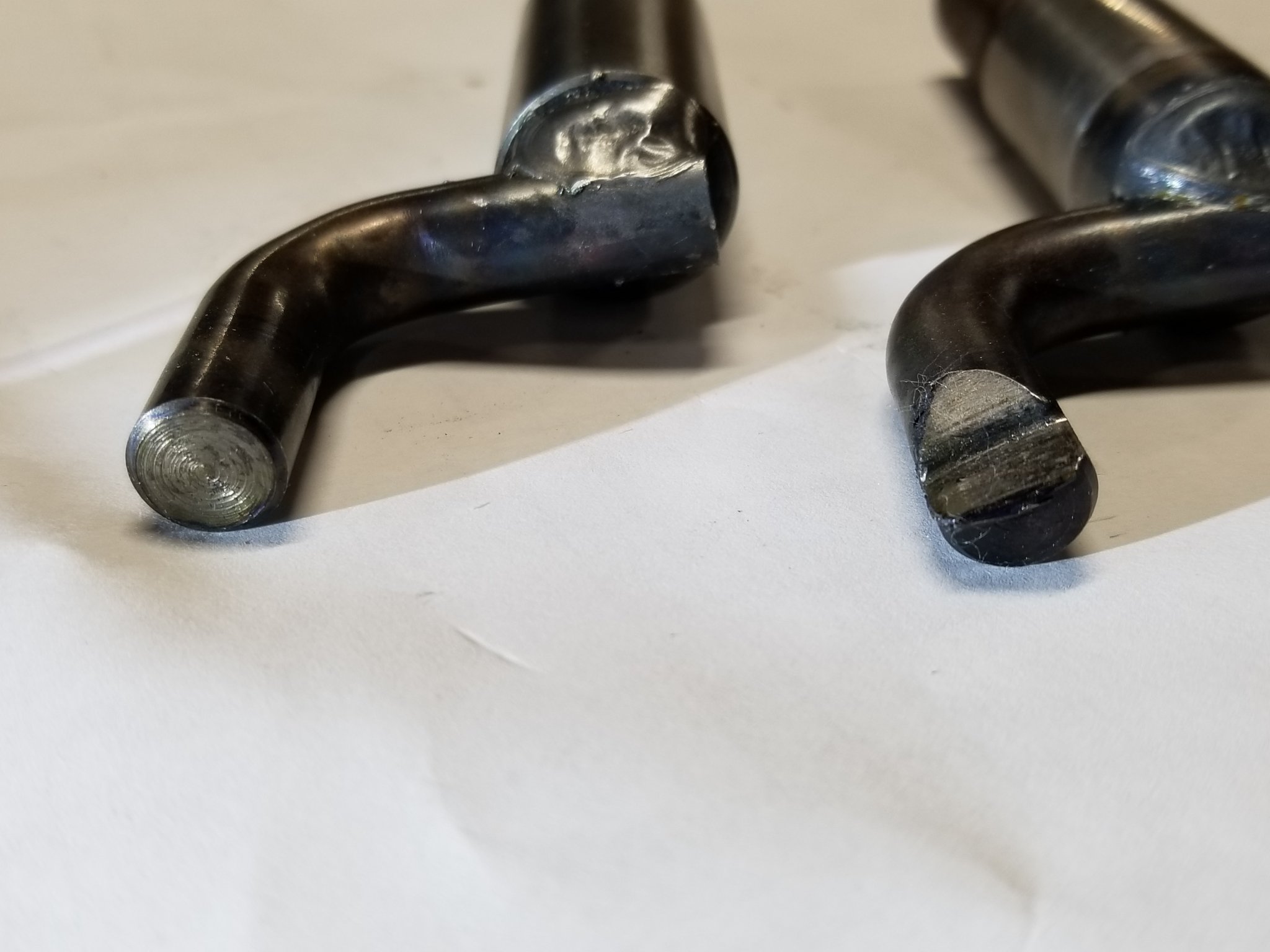

I've been following this just out of interest. Looks like Kubota did away with the overrunning clutch on the new parts. I don't see the need for it with HST - you can still control the tractor speed with the treadle.
By the lack of wear on the lower part of the coupling ramps, I'd say the old one wasn't fully engaging. Probably good you replaced the engagement arm.
This is the reason I am replacing the engagement arm. It would be an easy fix but the part was cheap.

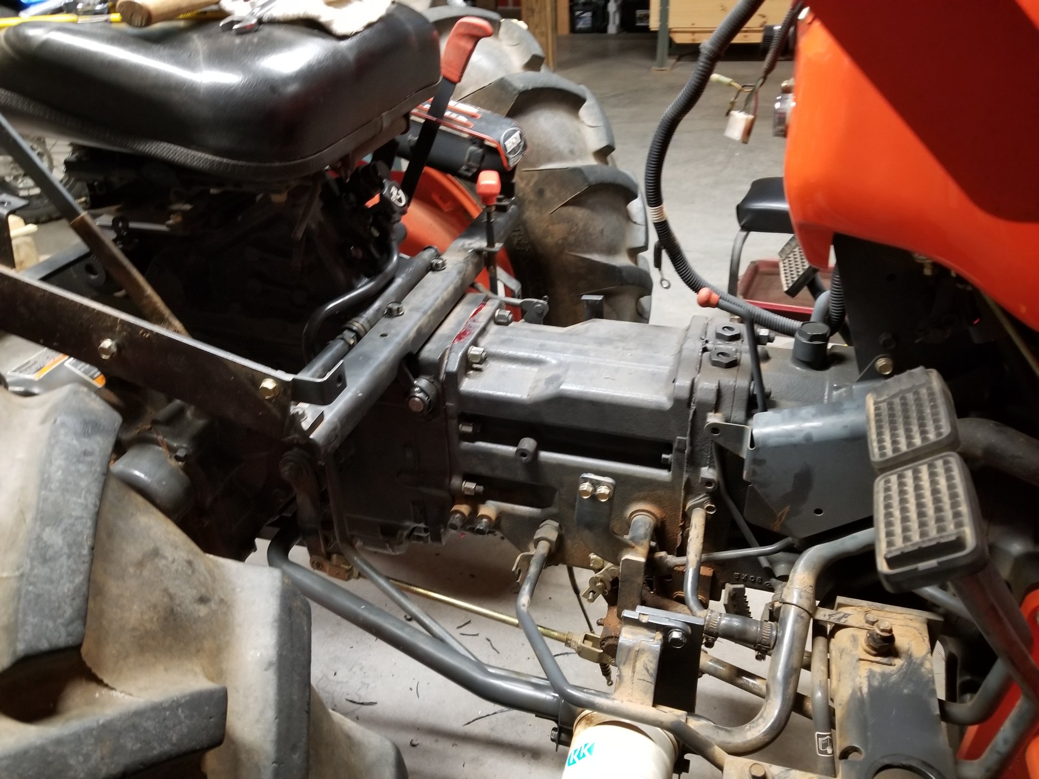

Back to one piece. The only tricky part was getting the spline collar to line up so it would slide together. Did a dry run and tried an couple things along with a bit of wiggling with no luck. Backed it apart and sat there thinking for a couple minutes and came up with using a length of string. Looped it around the collar and tried again. The string allowed me to rotate the little bit needed to get it together. Backed it all off again. Applied sealant all around except for the very top section between the bolts. Got it back to going together, removed the string and applied sealant to the last section. Slid it together the final 1/4" and bolted it up! Easy peasy!

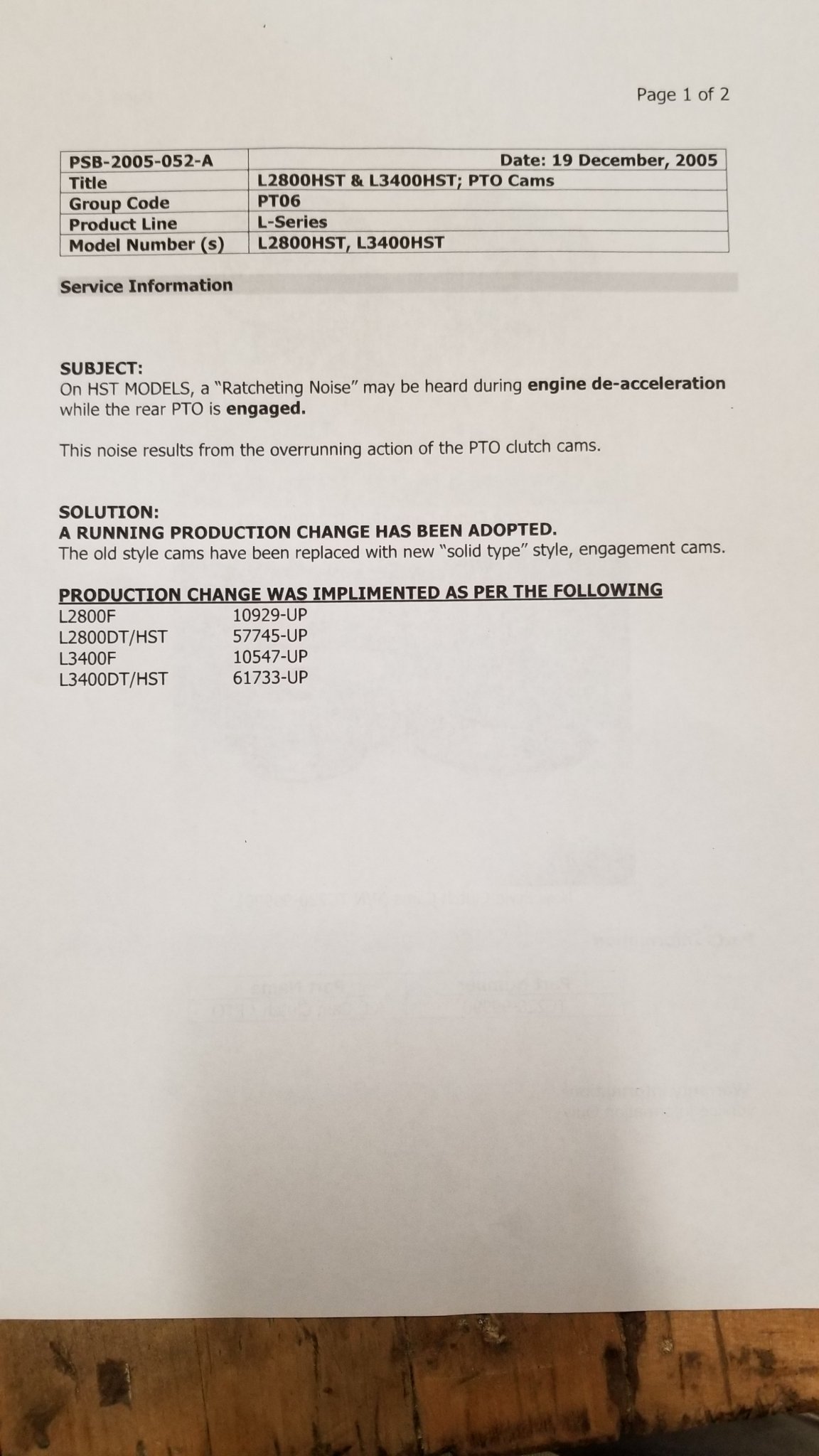

Here is the service bull8but I see it doesn't include the 3800 for some reason.
Maybe its was updated with your model.
When you cut the throttle with the pto still engaged ( brush hog attached) is there a loud ratcheting or clacking sound.
