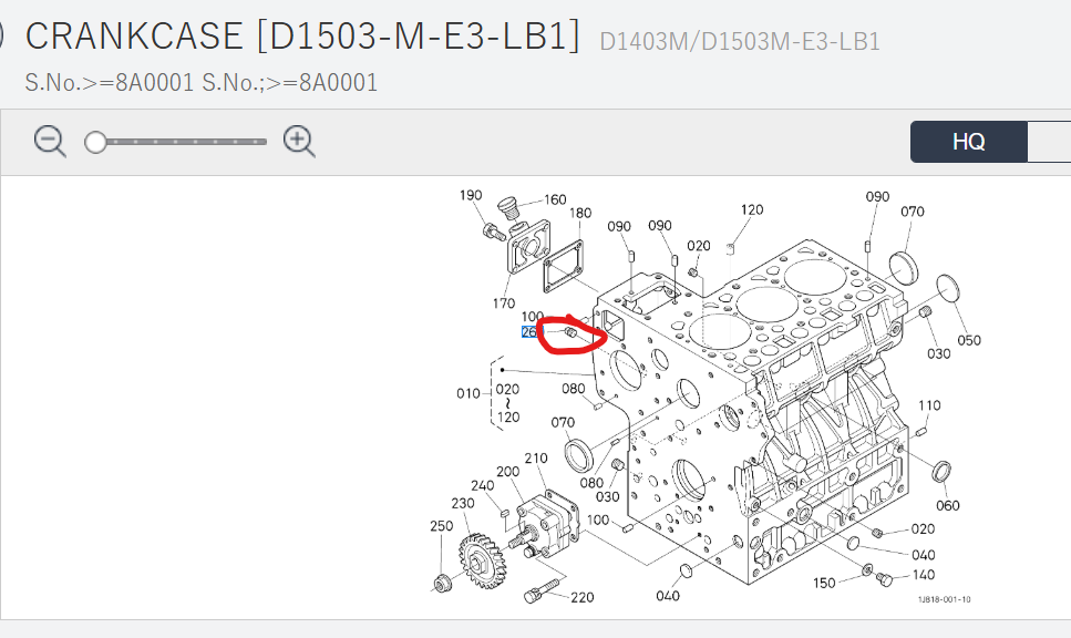

Each time refilled and drained the radiator it was right at 4 liters/quarts. This tractor radiator capacity is 6 liters. This little 1.3 liter diesel likely has about 2 liters of coolant in the block and hoses, so there is the extra that does not drain each time opening the drain on the right side of the radiator. This engine does not have a block drain to drain the fluid from the cooling channels in the block, like the Chevy 350 and 454 marine engines I have owned in boats previously.

Thank you sir for the correction--interesting that is not mentioned in the service manual.
