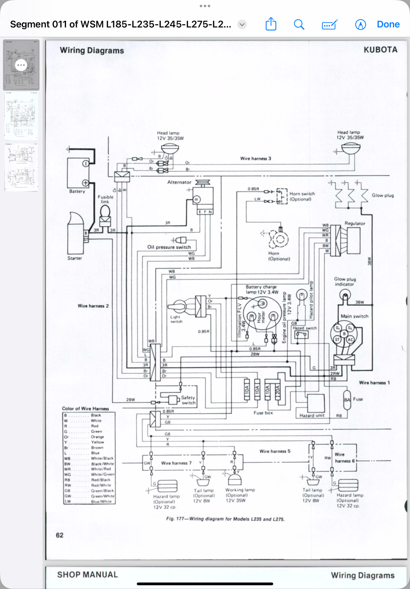

Do you have the WSM (aka service manual) with the wiring diagram?

Regarding the wiring, it sounds like I need to at least get the glow plug indicator back into the picture. Russell sent me a wiring diagram back when we were getting it started, so I have that to look at anyway. It doesn't seem particularly simple to me! ;)

Ok you will have to refresh my memory on you tractor and how you are currently using the glow plugs and how you start the tractor.
But I was running this through my thoughts today. If you are basically using a piece of wire between the battery terminal and the glow plugs then you can simply mount the glow plug indicator on a board and attach a wire to both sides of the indicator. Then use that circuit just like the wire you are currently using. The board will just keep you from burning your hand trying to hold the indicator. I suggest using something like the woode paddle from a kids paddle ball.
If there is already a key switch involved then please take some pictures or provide some sketched schematics of the wiring.

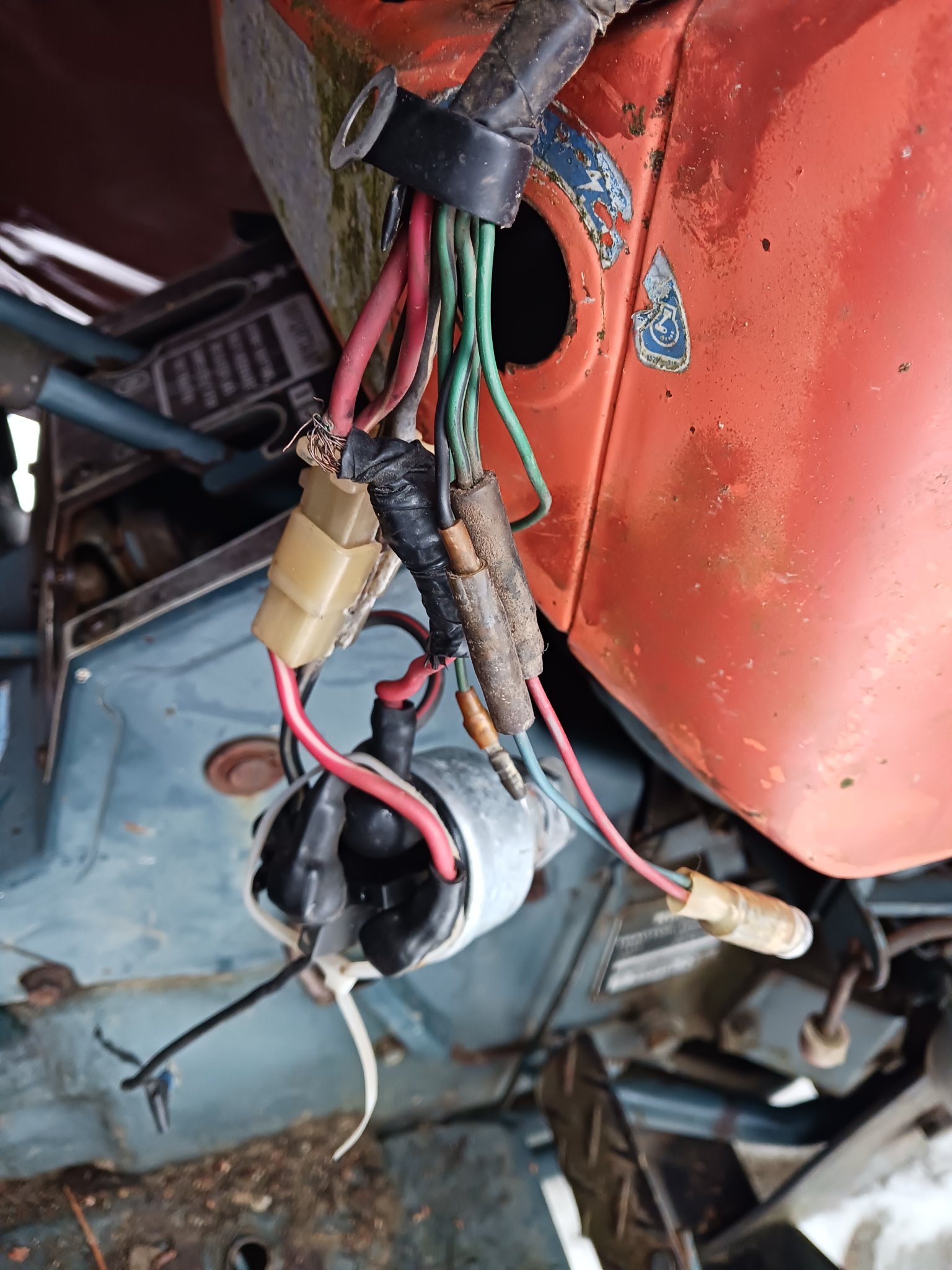

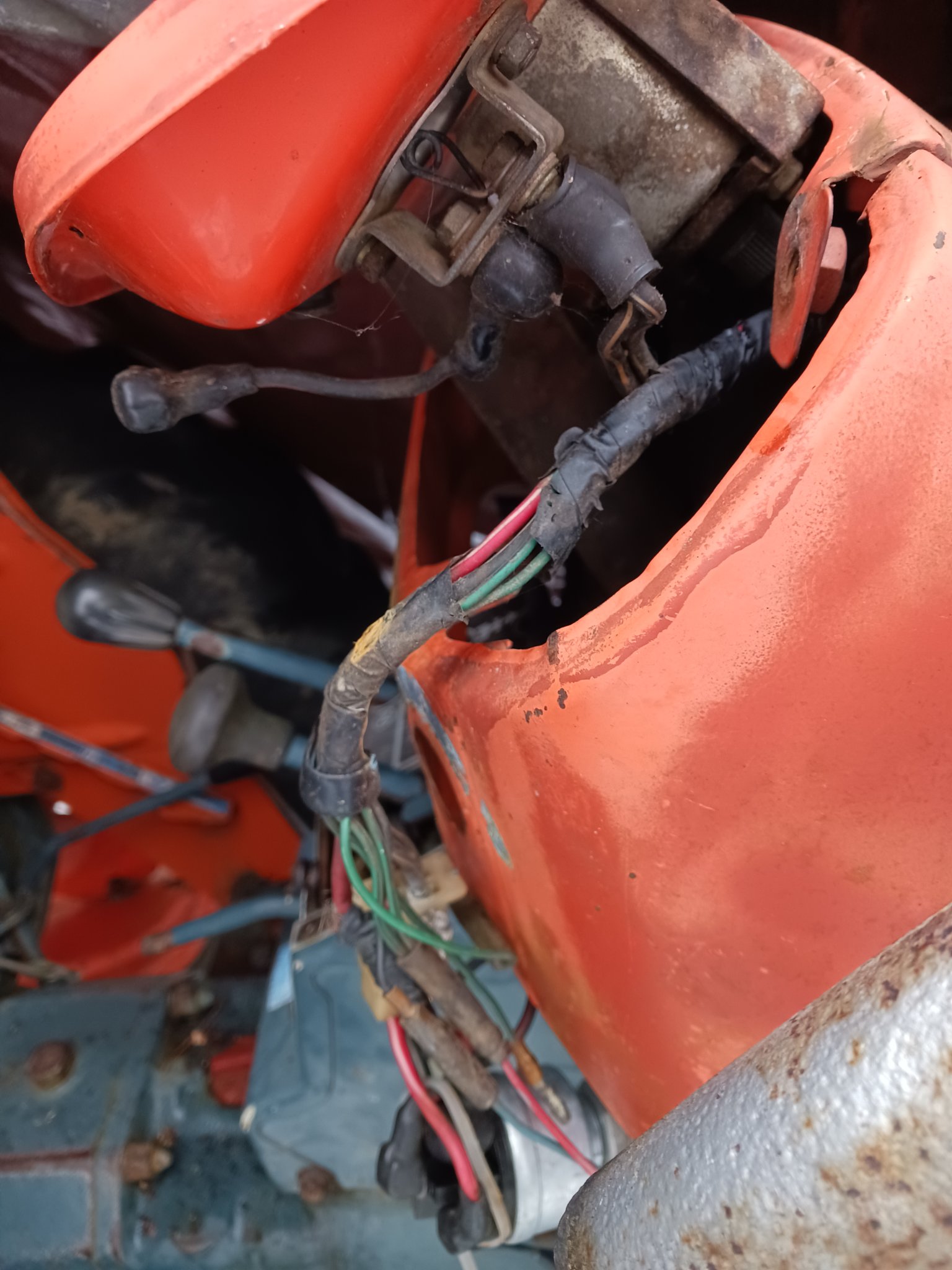

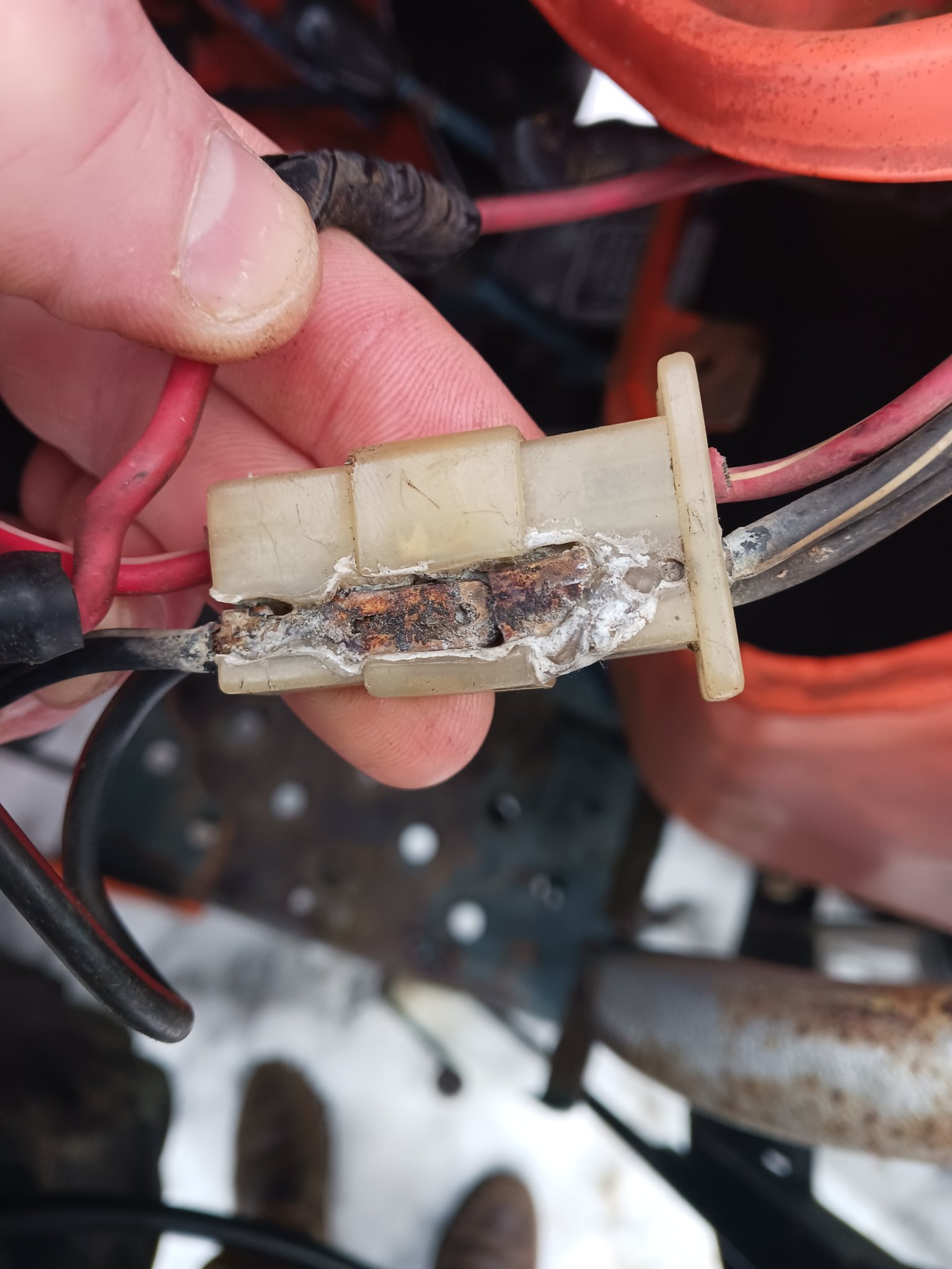

Here are some pics of the rats' nest. Note that among many other issues, the plastic connection appears to be melted and corroded where the GPI connects to the main switch. It looks like I could cut the large black/white wire which leads to the melted/corroded plug and connect that to the wire which I touch to the battery to heat the GPs. And then connect the other end of the large black/white wire back to the glow plugs (it currently goes nowhere). Is this sound logic?
Having the wiring diagram inspires me to actually fix all the wiring one day and it isn't overly intimidating anymore. However there definitely seems to be quite a few problems, omissions, shortcuts, etc.

1st problem is the 'aftermarket switch'. get make/model and CONFIRM it IS a direct replacement for the Kubota switch. You need to confirm power to the glowplugs ONLY happens in 'preheat' and 'start', NOT in 'run' position. Best to buy the Kubota switch ($80)
2nd, get the correct 'glow plug indicator'($50)
3rd, remove ALL the bad or suspect wiring, take pictures(lots), replace connectors/wires are needed. This isn't a 'terrible' or 'complicated' job, just go slow and confirm as you go.
I'd make a diagram of what IS there now to see what has been 'modified' and go back to ORIGINAL wiring. If possible use same coloured wires as factory.

I purchased a new wiring harness for my L185 from the dealer. You may want to see if they are available for you tractor. They would be easy to remake but some what time consuming and the connectors would probably be difficult to get exact replacements. I doubt that the connector for the voltage regulator would be available so you might have to replace the connector on the regulator itself
My key switch just had screw terminal with no connector near the switch. Most of the wiring looks correct so you could just cut the connector off and connect the wires together to get thins working.
The melted connector is concerning though. That indicates that something down stream was drawing a lot of current and there is no fuse (or fuse is larger than it should have been. I recall that there is a lack of fuses on some of the wiring. You should investigate if any of that wiring is chewed or damaged going to ground somewhere between that connector and the end of the wire (load point)
@GreensvilleJay states something that is not really obvious in the wiring diagram about how the glow plugs are powered in two switch positions (glow and start). The picture of the indicator shows that is correctly wired on the indicator itself. The single wire at the bottom will get power in the glow position. The indicator will drop the voltage down since it is really a resistor. So the top side of the indicator connections shows two wires. One of those goes off to the glow plug connections. So in the glow position that would be less than 12 volts.
Now in the start position the second wire on top gets voltage. The glow position of the switch is now off so no power supply is going through the glow plug indicator. But the start position of the key also applies power to the starter. The starter will draw enough power to drop the voltage on the battery so the glow plugs still don’t get a full 12 volts in the start position (when cranking).
Now if you don’t push the clutch down the safety switch is not going to allow the starter to activate. But you will be apply full battery voltage to the glow plugs. So don’t do this for very long or you will burn out the glow plugs.
On my L185 the key switch is really just a power on/off and headlight power switch (off/on/low beam/high beam). There is a separate spring loaded, two position switch that applies power to the glow plugs in the left position and power to the starter in the right position. When released the switch is in the middle position and not applying power to anything. Does your tractor have this second knob operated switch?

re: burned connector
One way they go like that is they are not really snug. You've got a 1/4" tab , male sliding into a 'female'. Over time ,vibration and old age loosens the 'grip' that is suppose to firmly mate the pair. when that happens you don't have a GREAT solid connection, so may get an itty bitty arc, next time you put power thru, 2 itty,bitty arcs,3,4 lots more...eventually you end up with what's in the picture.
good news is you have a wiring diagram and the original harness,so take lots of pictures and reapir what you have. all the connectors are available through electronic suppliers. Some here may know who.
