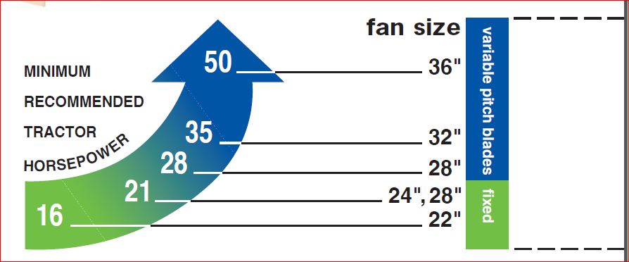

What size fan does your sprayer have, that is where the HP demand is needed.
