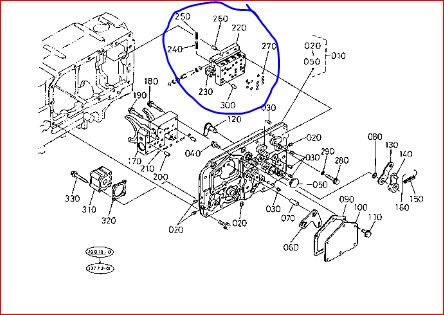

Now onto replacement easy as pie, since you can not move the lever to neutral you'll have to do it after the fact just unbolt the shift cover on the side of the transmission 3 Bolts I do believe, pull strait off, and you'll see this:

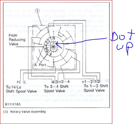

With a wrench turn the selector till the dot is up that's neutral.
unbolt the other side, and remove cable assembly, replace starting on that side place shifter in neutral, when reinstalling transmission side first dry fit to see if the parts align if not you might have to adjust cables to get it to align to neutral, then after install, before reinstalling covers dry run and make sure it goes in every gear.

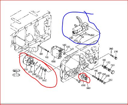

In order to get to that O-ring, it's rather involved.
you need to remove the side cover.
The real issue is that some of the parts need to stay in the transmission, the 2 groups of parts in blue, to get to the parts in red.
You can only pull the cover out about 1/2" if you don't unbolt the blocks in blue.
and when you reassemble the side cover it takes some talent and patience to line up the shift blocks with the side cover before you can close it up.
There is also 80 some O-Rings in there, and when you unbolt the blocks some of the bolts will even have O-Rings as washers for sealing.

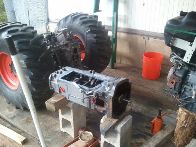

I have taken mine right down to nothing 3 times, I bought it with a broken transmission, and had to rebuild it after a mechanic had totally messed up the rebuild.

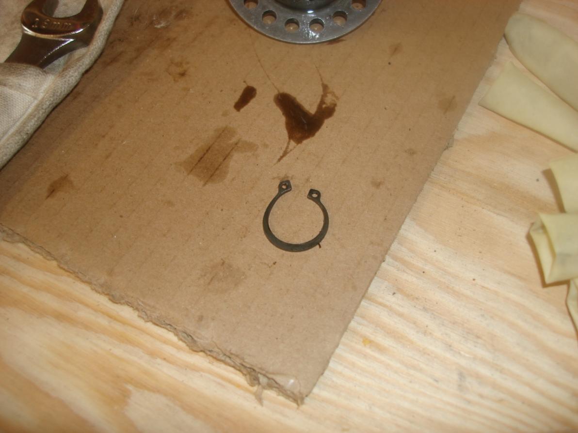

I got everything apart and the o-rings look good, One odd thing, I took the snap ring and washer off in the early stages and at one point thought to just put is all back together and the groove was no visible to install the c-clip (060) even without the washer (050).
Someone has been in the cable assembly in the past because it had silicone for a gasket. I am wondering if the the never seated the clip and the rotary valve walked back enough for the o-rings to not seat?
chris989
L3450
Oct 5, 2016
37
boise
update, after a closer inspection,, the c clip is distorted, I tried to install it on the shaft while out of the case and i can easily slip it on an off without snap ring pliers.
