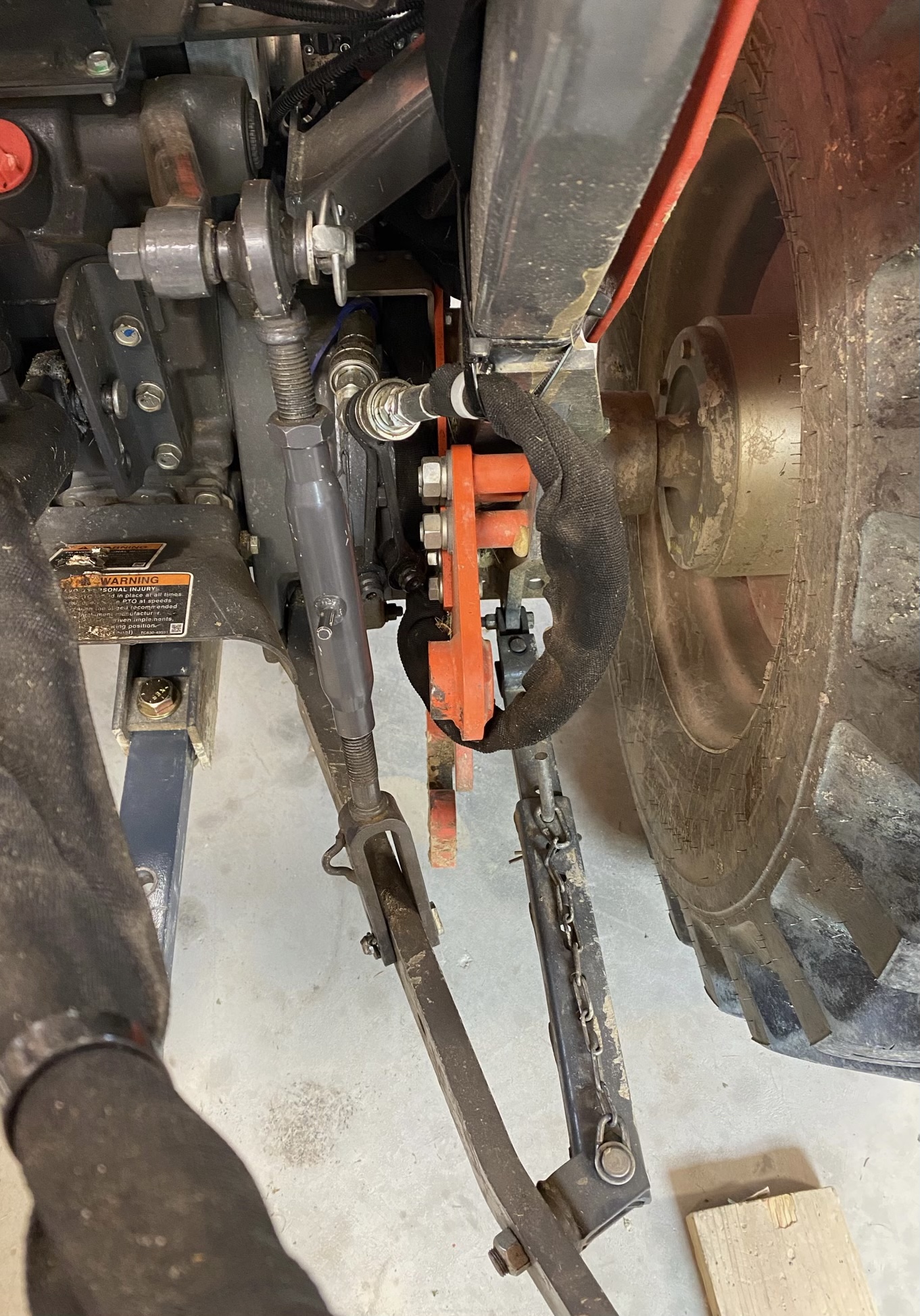

Also if you decide to upgrade to telescoping stabilizers, be sure they will clear the backhoe subframe. Maybe somebody with a L series and backhoe here can verify, mine just has the turnbuckle stabilizers
Here’s an L3301 with a BH77 subframe and the telescoping stabilizers.
