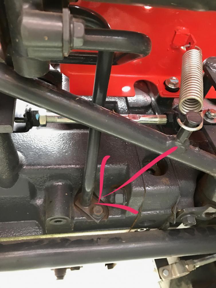

Found the source of the noise. See the attached picture. Its coming from the HST transmission line that goes to the filter. The sound appears to be coming from exactly where the line goes into the side of the tractor but its hard to tell.

It is likely the charge relief valve operating that is making the noise. The tube you are pointing out is the delivery tube from the HST filter to the HST itself. The power steering pump on the engine is used to provide charge pressure. The noise might vary a little if you turn the steering but it might not either! If the HST is working good there is nothing to worry about except the noise. The basic L series are not noted for their quietness.

Thanks for the info. While the tractor is making the sound if I turn the steering wheel, the sounds does stop for maybe 2 seconds and then it returns. This is consistent with what you are saying. I was going to take the tractor to the dealer and see what they had to say but it's probably not worth it at this point. Going to change the fluid and filter asap. I'm not too worried about it as it's made the sound from day one.
