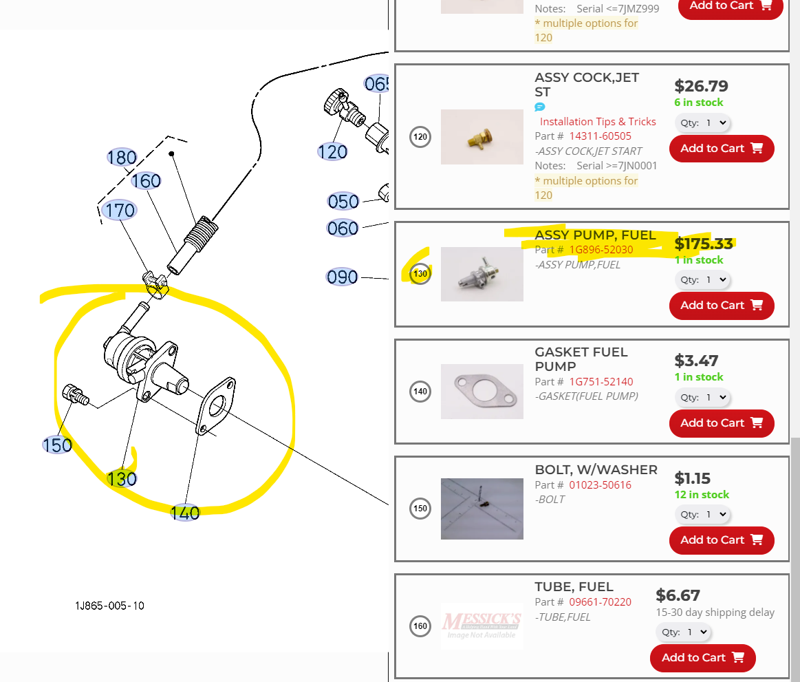

I'm wondering if the lift pump is either defective of not connected properly ?
I KNOW for a fact that my BX23S ran FINE without it, as I spotted it disconnected while cleaning underneath. Have NO idea how long it wasn't plugged in,though filters were changed 50-70 hours previously.

I'm with @Sidekick. Just to be sure, check the fuel bowl for water and look around the governor area for any obvious damage.

You have a fuel supply problem from the tank, through the filter, or a mechanical fuel lift pump failure.

Seems like I recall hearing about lift pump problems on the L2501 tractors.
It is the same lift pump used on about 70 models, almost all Lxx00 and Lxx40 series tractors, plus many industrial engines.

I just posted this on another thread. My L2501 has about 100 hours and started running rough last week while tilling a field. The engine finally quit and I wondered if it were a lift pump issue like I had read about. I unscrewed the fuel bowl slightly to see it fill up, so I was thinking maybe not a fuel issue. I finally unscrewed the bowl completely to see some crud on top of the filter. The filter looked good viewing through the plastic bowl. I then pulled the fuel line at the filter bowl from the tank and fuel ran out and stopped. It was obstructed. Turns out I had fuel microbes and I had to drain the tank. I am treating it with Bio Kleen and hopefully that is all I will have to do. It might be worth looking into.

I just posted this on another thread. My L2501 has about 100 hours and started running rough last week while tilling a field. The engine finally quit, and I wondered if it was a lift pump issue like I had read about. I unscrewed the fuel bowl slightly to see it fill up, so I thought it was not a fuel issue. I finally unscrewed the bowl completely to see some crud on top of the filter. The filter looked good viewing through the plastic bowl. I then pulled the fuel line at the filter bowl from the tank and fuel ran out and stopped. It was obstructed. Turns out I had fuel microbes and I had to drain the tank. I am treating it with Bio Kleen; hopefully, that is all I have to do. It might be worth looking into.

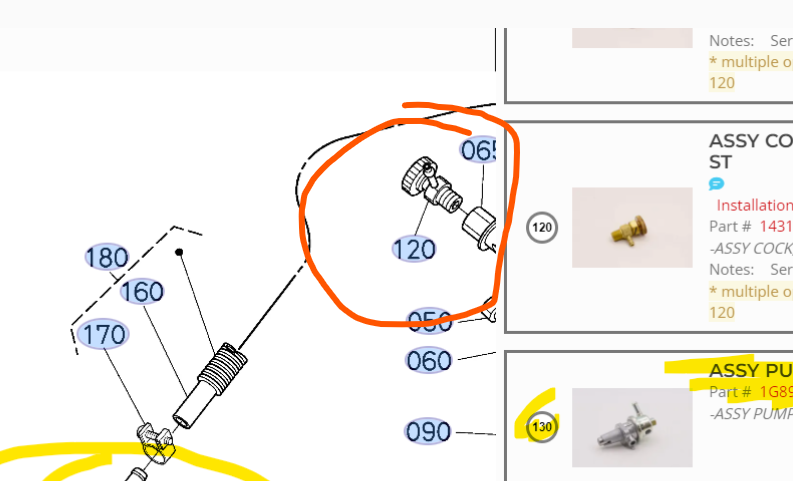

The air bleed valve above the pump opens and when turning the engine over nothing comes out. Not sure if there is a manual bleed for this or I have to go to the injectors. Seems like I could have air or the lift pump is failing.. Not really sure.

I recall seeing a similar issue on a 2501 recently. The tractor would operate fine at full RPM and then after lowering idle speed back down, it would run rough. Guy replaced the fuel pump and it resolved his issue.

I have read that this pump assembly has been problematic for the L2501, but I'm not sure if there is a specific way to test it to verify if it is truly bad.

You purge the air out by opening this valve and cranking it.
Thank you, sir.
I opened it and cranked it over a few times, but no fuel ever came out, but it did start up. I ran for about an hour and a half before it started to sputter again. Let it idle, and it seemed to clear up.
Not sure what's going on.
Check the fittings on the separator they are know to be bad and suck air.
