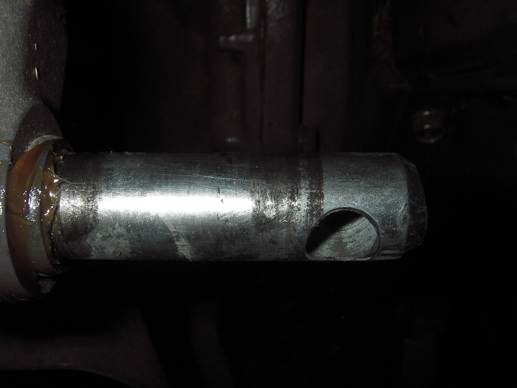

Just in case anyone else has not greased these, they need it. Fortunately they can be replaced easily but ...
The other side was worse but I had already greased it and didn't want to clean it off for a pic.
I'll be taking the lower pins apart as well.
No zerks to be found.
5,720
3,036
Use moly grease on pins, bushings.
