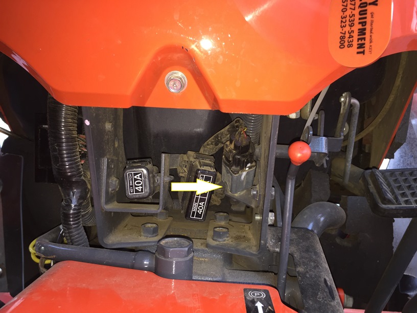

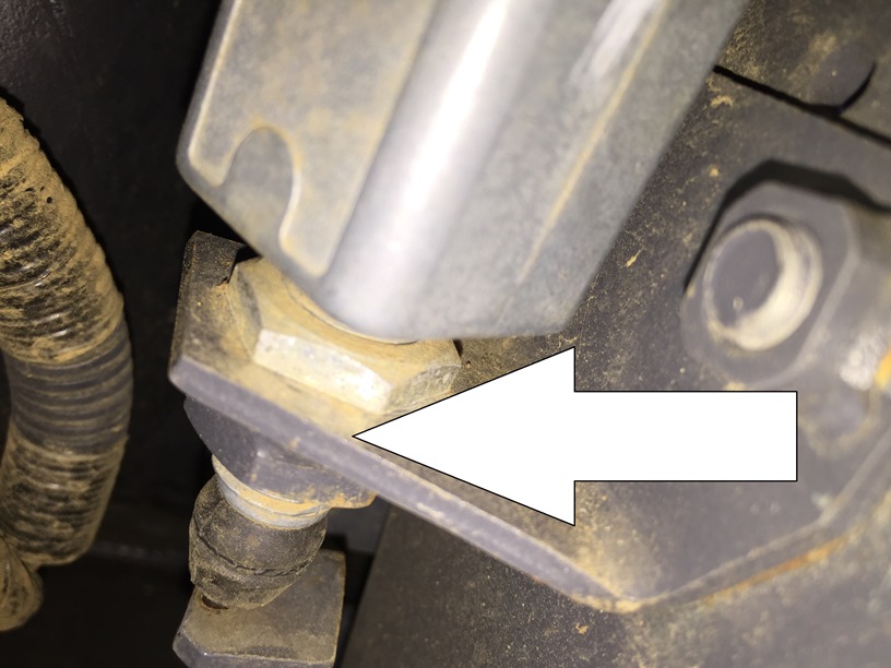

Not sure what yours might look like. Here are two shots of my L3200's HST switch. Maybe yours is similar. The switch on mine is located in the center area below the dash. One picture will give you an idea of the location and the other shows the plunger that is actuated by a tab on the HST pedal and the locknuts. After making the adjustment I never had any trouble after that as long as I owned it. Hope this helps.

Just to update everyone, the lubricant was not a long term fix.
Steps I followed to "fix" it.
1. Take the black cover off on the treadle pedal side of the hum that attaches with 12mm wrenches/sockets.
2. Place a block or wood or similar underneath the back of the treadle pedal. Might be optional but takes all force off the switch.
3. Take the single grey bolt out that holds the electric switch.
4. That will free up the switch with the adjustment bolt.
5. Loosen the bolt that holds the switch to the bracket.
6. Rotate the bracket to make more of the bolt that goes through the bracket. The workshop manual says 1.88-1.91 inches from the switch to the welded nut not he bracket, but look at the picture so you know where to measure.
7. Tighten the locknut.
8. Put the grey bolt back in. The bracket has a "nub" to index it which is why only bolt is required.
9. Put the black cover back on with the bolts and nut.

+1 for chim and his pictures
this was what i needed after replacing the return to neutral arm that had broken
readjusting the petal and the mechanism along with this switch position... thx
Your photos helped me so, so much. Thank you! I installed a 3rd function on my L2501 HST and when I was finished the tractor would not start. I could hear the click, see the lights, but turn the key and...nothing. Similar to many other posts in this forum.
I had to take off the fuse brackets and the hst bracket off to install a hose guard for the new hydraulic lines per the install instructions. When I reinstalled the hst bracket I didn't realize the plunger had to hit the metal plate underneath. After searching many of these forum posts I found your picture, adjusted the HST switch so the plunger hit the metal piece behind it and CRANK! I am so happy I don't have to go to the dealership. Thank you again!
