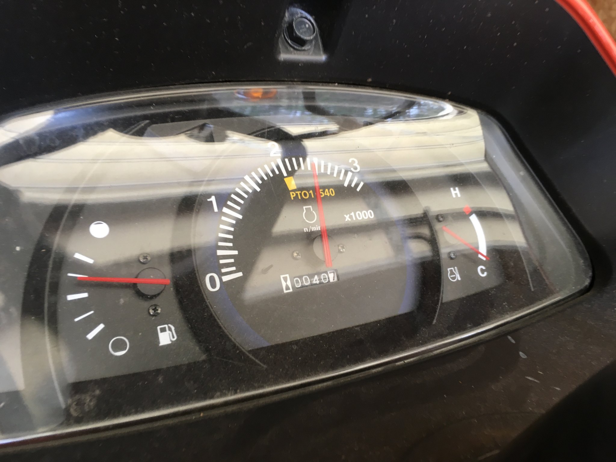

Hello ladies and gentlemen, I have a new l2501 with 4hrs on it. When I am running the tractor at full throttle the rpms are topped out at 2250rpm while under load and 2350 while stopped? It seems like it should rev higher but I don't know?
Thanks in advance for any help/information you all have 🚜
Dustin View attachment 57481
Your pic shows that to achieve the required 540 RPM on the pto, the engine needs to be at 2000 +/- RPM.
That is probably pretty close to the peak torque / horsepower range of the engine, so no need to run the engine right to the pin. All that will do is burn more fuel, make more noise, and put more wear and tear on the engine.
Kubota designed it to run at that 2000 RPM for a reason.
