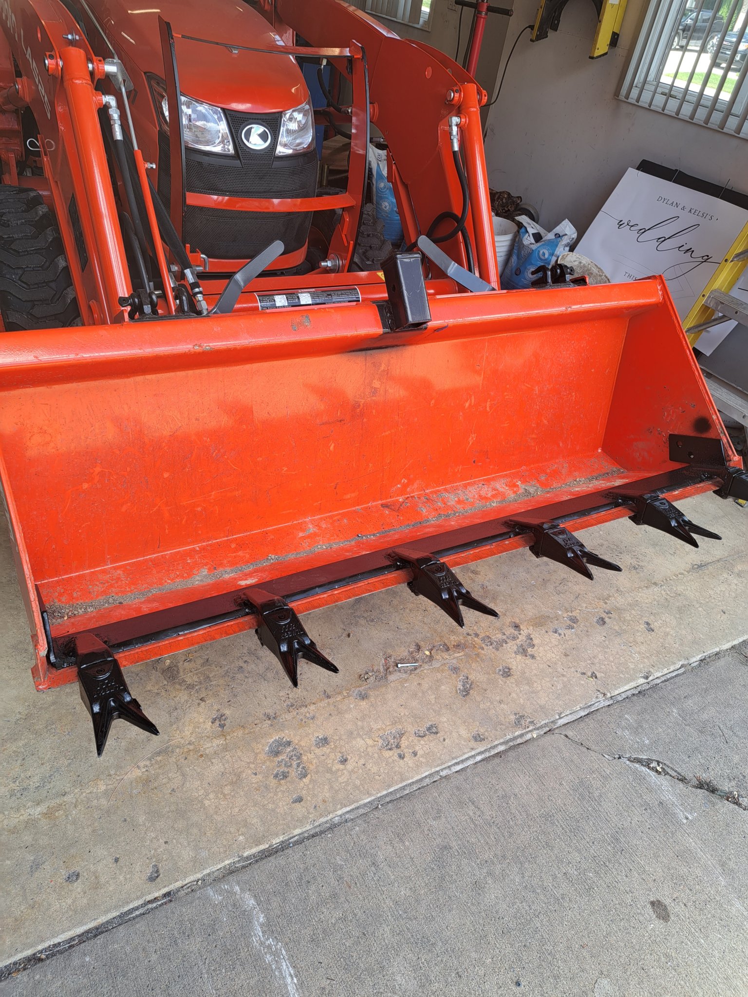

I have the Piranha. Increases performance digging and cutting through roots in addition to protecting the factory edge. I haven’t beat on a lot of large rocks or chunks of concrete with it so can’t say how it would hold up to that. I know it’s good with potato size rocks. Took less than 30 minutes to install.

Thank you for the advice. So it just slips over the front edge and bolts on the sides of the bucket ?

Exactly. The side of the bucket isn’t very hard to drill.

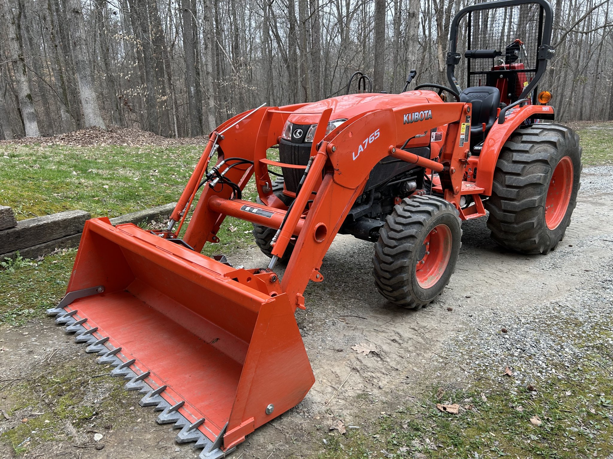

I made this one. It was relatively easy/fun to make.
Honestly, I only made it cause I thought it looked cool... :giggle:
Recently I was digging a pile of dirt with the regular blade when it dawned on me that I had made this thing, and it was just sitting there in the barn.
So I put it on and WOW...it made a huge difference.
It slips over the edge and is bolted onto the sides as well.
