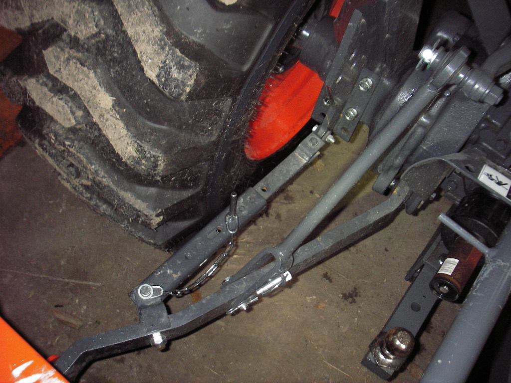

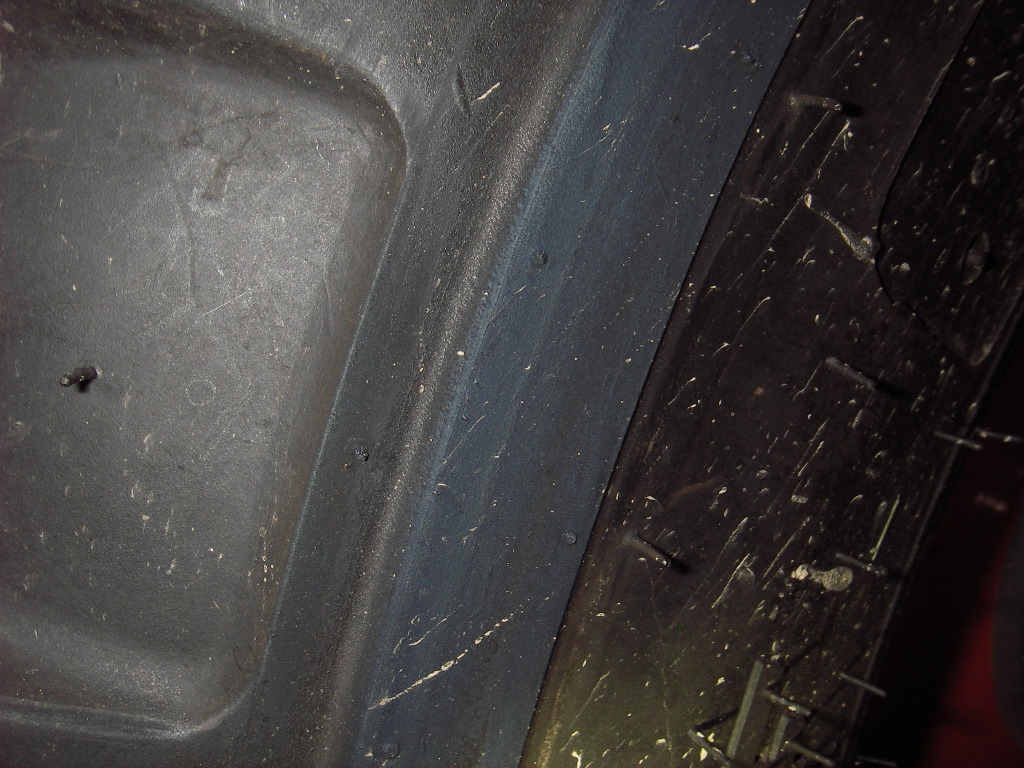

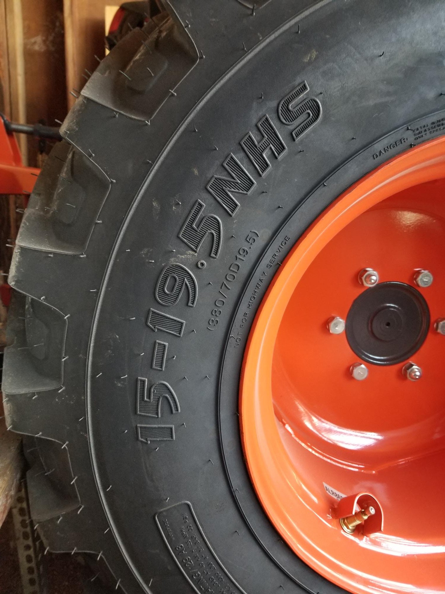

Hi guys:
The stabilizers rub against the tires.
Dealer says that's never a problem, something is wrong. But hasn't offered a solution except to say I don't need wheel spacers.
I'm starting to think I need to mount the outer end of the stabilizers inside and under the lift arms which will require some fabrication.
I would really appreciate a picture from someone with this tractor, without the problem.
Thanks

Hi guys:
Thanks

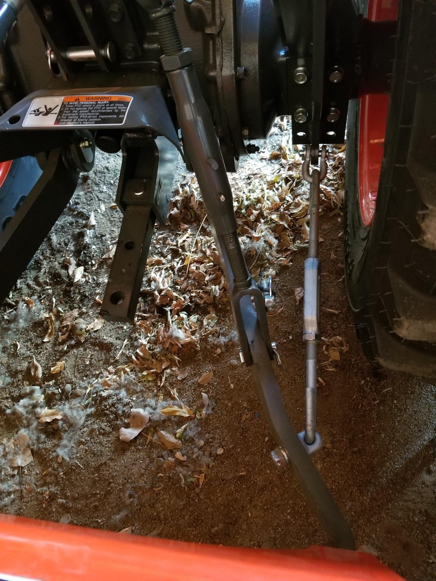

No Issues with stock manual stabilizers & R14 Tire setup on my L2501DT...

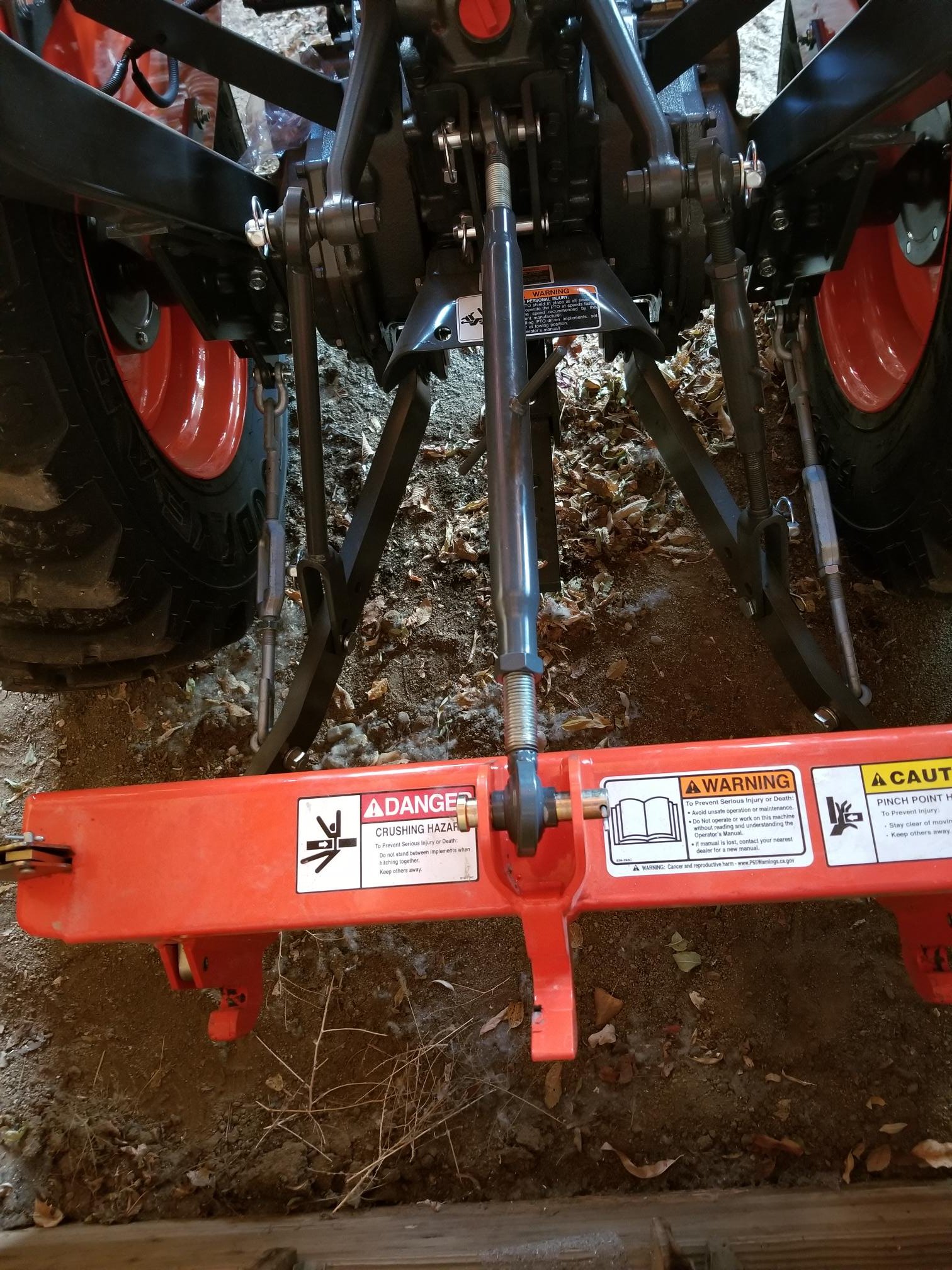

Thanks a million for the pics NvRudder! The non turnbuckle stabilizer is wider and also connects to the lift arms further out.
Implements are:
RCR1260 on which I had to turn one 3PH pin inside.
FDR1660 on which I can adjust the width Ok.
Kubota weight box which is the biggest problem.

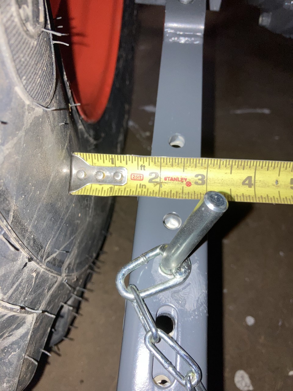

Pawnee, what is the distance between your tires?
Orangeman, could you meaure yours? Just to compare the 2 different tractors.

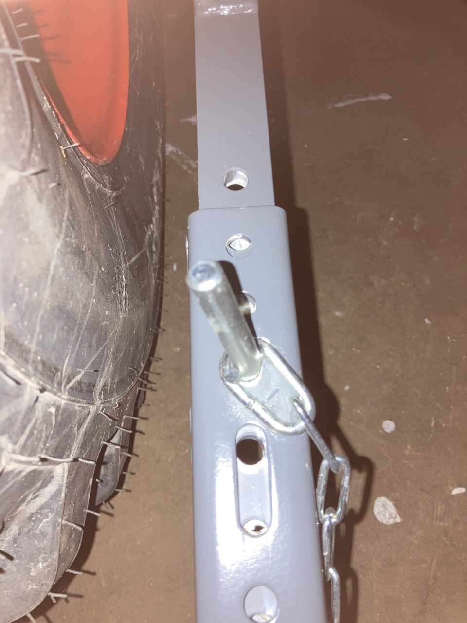

Just took a pic for you, hope it helps. Bad quality in the dark.

I have R4 tires with inside clearance = 29"

I have 29 1/2'' between the tires on mine, I have r14t tires.
