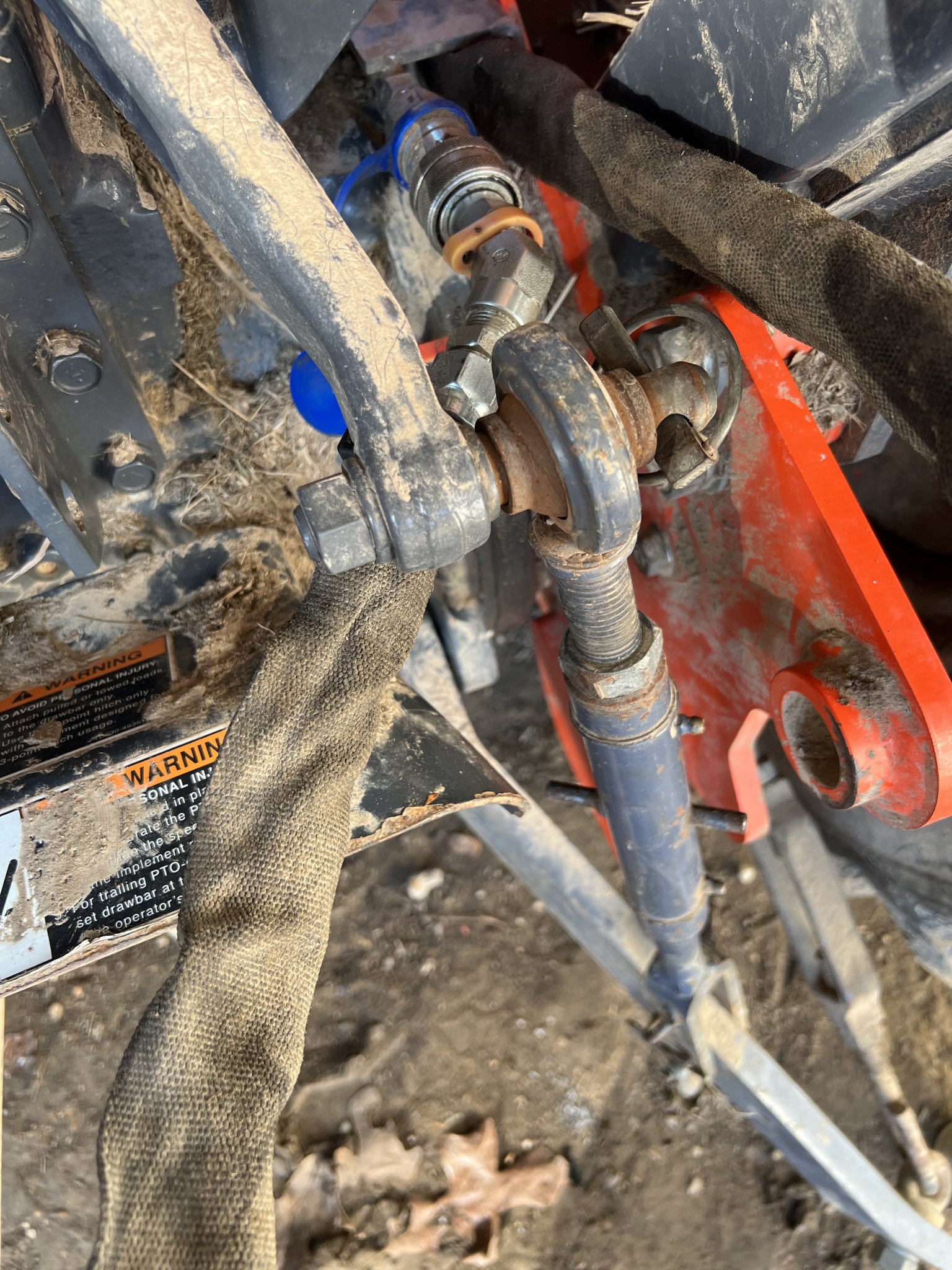

now go read the thread about the 3pt arms pinching the BH loop hose 🤣 (I just got done replacing that hose this morning 😂)

That was my next thought looking at that loop.
Does anyone make a simple manifold that allows them to lay beside each other instead of a wide loop?

I just did as a few other members here did and added a 45 degree adapter at the hose end (new hose is also about 6 inches longer).
