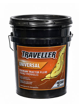

The Traveler brand is fine for a gear drive tractor. I use their universal transmission and hydraulic fluid. Is that what you mean? I would Not use just hydraulic fluid myself.

I only used this:
for the hydraulic fluid and cleaned the transmission strainer. It was working at first and then just stopped...Thanks for you response!

Then everything you did is correct (fluid is fine and screen is clean) and should not have caused any problems.
