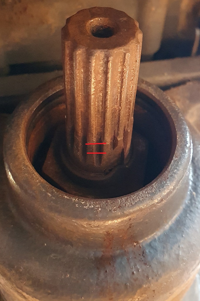

...and on the front axle drive pinion:
NASTY, huh?
That slipping coupler must have acted like a grinder on those splines... Because, any time the front wheels are turning, that drive pinion is spinning. Notice how well the shaft cover was protecting BOTH shafts from moisture <cough>. That's the old o-ring still there in the inside of the axle casting.
I mean, duh, the prop shaft is going to get warm, just from heat gain from the groove in the engine oil pan that it passes through. What happens when you shut the tractor off and the air inside the shaft cover cools off again? Condensation! You gotta let them puppies BREATH!

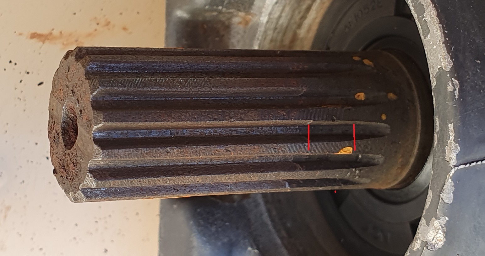

The unused spline length is between the red lines. It's not much, but I'll take what I can get! I'll grind out the split pin holes in the coupler large enough to plug-weld it solidly to the front drive pinion in two places (see image below). Given how trashed the splines are on that front drive pinion, there's no need to try to save their integrity. I'll complete the reassembly before making that weld, so that the coupler is perfectly aligned with the pinion. Utilizing that unused spline area will help align everything.
For the trans output shaft, I think I'll drill up through the split pin hole in the coupler to make a small (3-4mm) divot in the shaft. Then, I'll drive the split pin into that divot in the shaft to prevent the coupler from sliding on the trans output shaft.
By pinning the coupler to the trans shaft and welding the coupler the front drive pinion, the couplers will not slide out of place and then the prop shaft itself can just float between the couplers.
To get the added coupler length, I'm just going to get another NOS coupler, cut it in half, and buttweld each half to another NOS coupler. My son is a professional welder - he'll probably want to TiG the coupler pieces together.
It's curious that the engineers tried to make it um, *convenient* to remove the prop shaft. Just what were they anticipating? On the other hand, it seems somewhat unusual for industrial engineers, in the design, to actually facilitate replacement of parts that are prone to failure. {That should be part of the "right to repair" laws.]
Here's a pic to illustrate the surplus spline length on the prop shaft:
That hole is for the split pin, which is supposed to go across the coupler between the shaft ends to locate the coupler.
