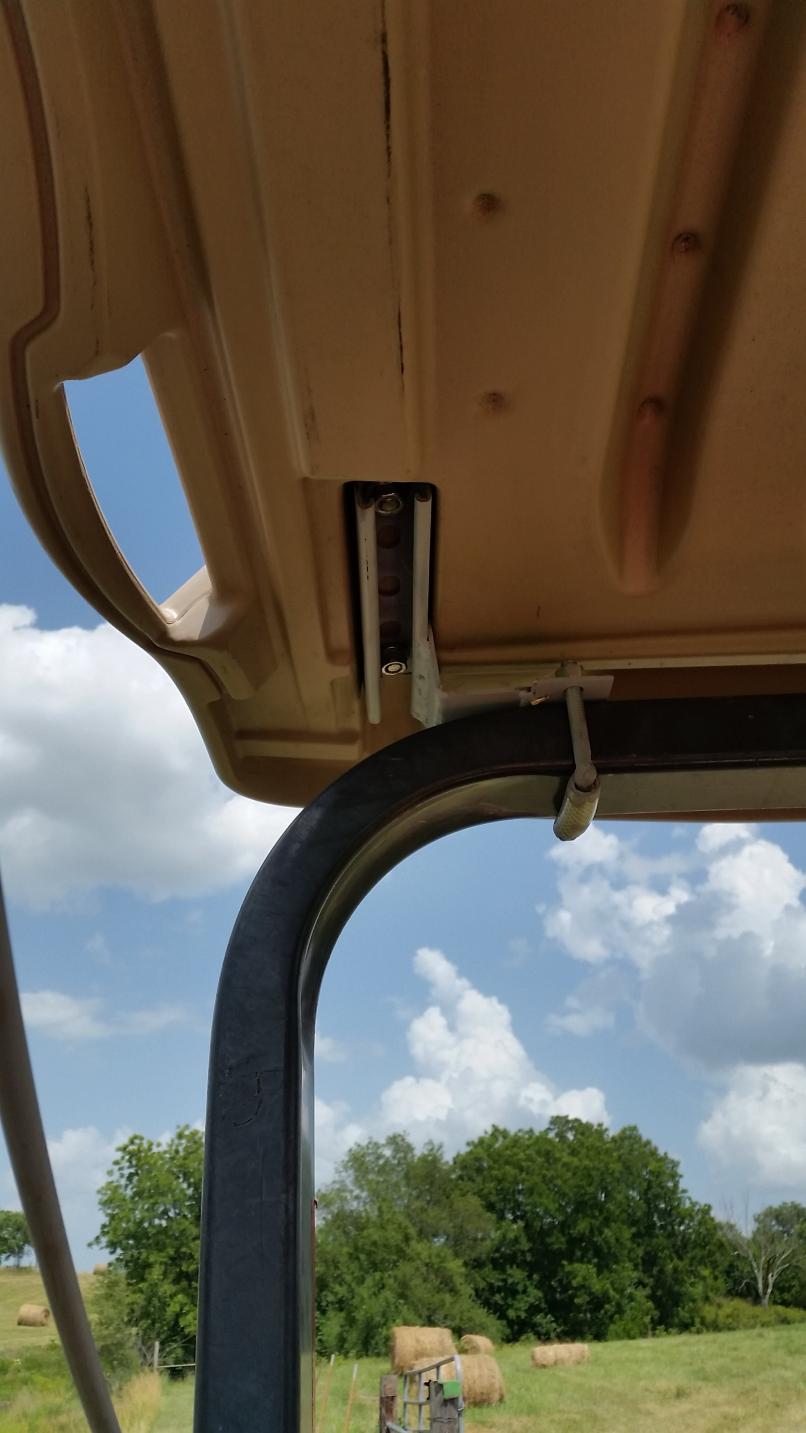

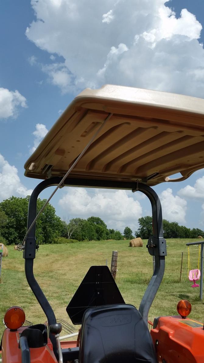

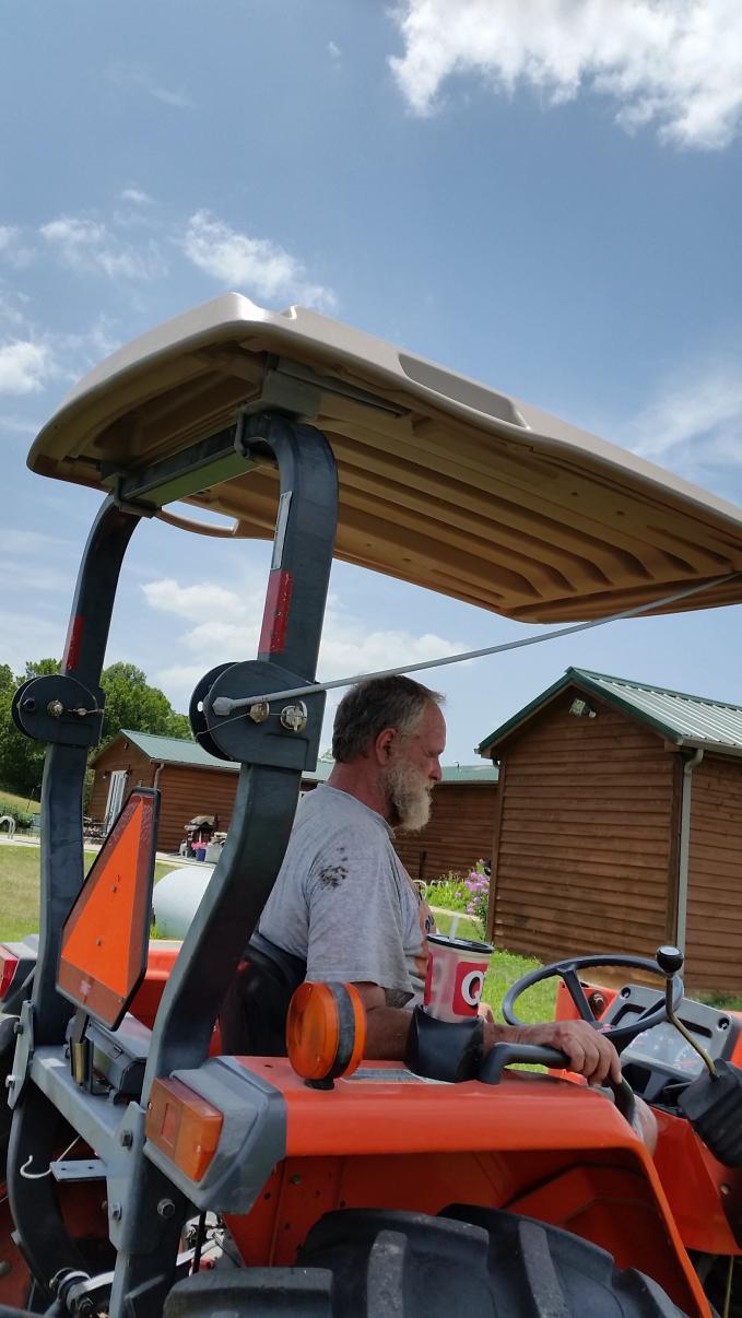

Al, here's some pictures of a canopy I built for my neighbor last year. $25 for the canopy at the local golf cart dealer, and some misc. iron. Used some threaded rod to make the clamps, and put some hose on to keep from scratching. Used a piece of unistrut for the bracket that is bolted to the canopy. I used all existing holes. Added the brace just because I had it and didn't want to have to remake something later if I didn't. Used bolts I had that fit the holes. Just a bit of welding required.

Here’s how I did it.
Last one is why I needed it easily removeable. Made the mistake of drilling the ROPS before I knew any better.
