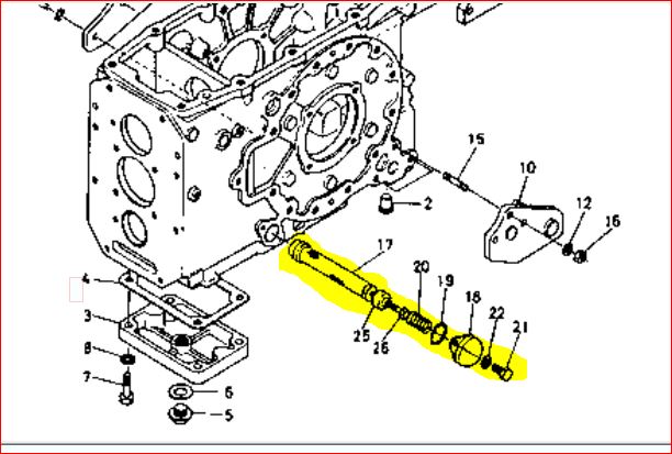

Look on the other side, inline with the hydraulic fitting, there is a cover with a single bolt holding it in pull it and pull the filter.

Thanks wolfman I just came across an article about that very screen. Awesome I will pull it Saturday. we bought two tractor and full service on both we have learned a lot so far. ford 8n and this Kubota. had to replace the oring in the fords lift cylinder. And now this one. hopefully this is the answer I will let you know. thanks again
