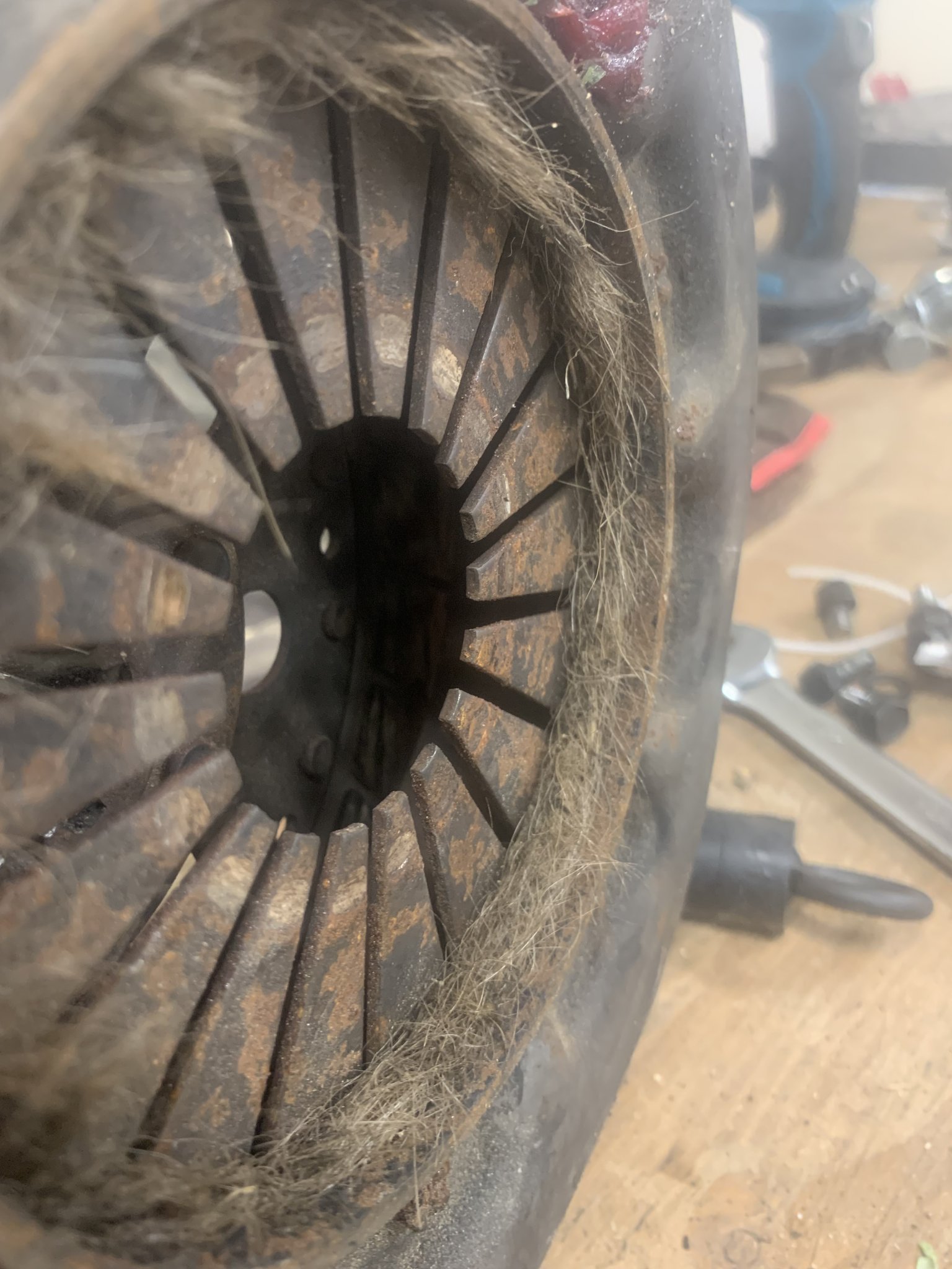

Thefirst picture shows animal hair inside the pressure plate so the forks would not spring out. Weird; I don’t know how that much hair got inside the case. It was full of horse, goat, sheep hair.
I cleared it out last night and am thinking about tearing it apart again and putting the old parts back in.

Had the same issue years ago on my manual transmission Pontiac Vibe aka Toyota Matrix.
That style of pressure plate is called a diaphram style. In my situation it was shells from walnuts. I presume a squirrel was slipping them into the bell housing past the clutch lever rubber boot.
The spinning of the fly wheel does a nice job of packing material around the outer part of the pressure plate.
I see you having two choices. A new pressure plate or putting the old pressure plate in a press and use the release bearing and press to depress the pressure plate to allow a more complete cleaning.
A tiny limitation in the movement of the pressure plate leads to slipping of the clutch.

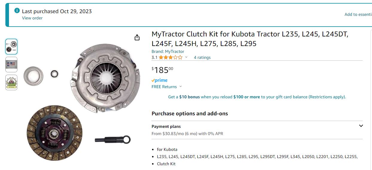

This clutch from Amazon was exact to the old one.
The pressure plate bolts depressed the pressure plate at least 1/4" down so I know the plate had lots of pressure on the clutch to flywheel.

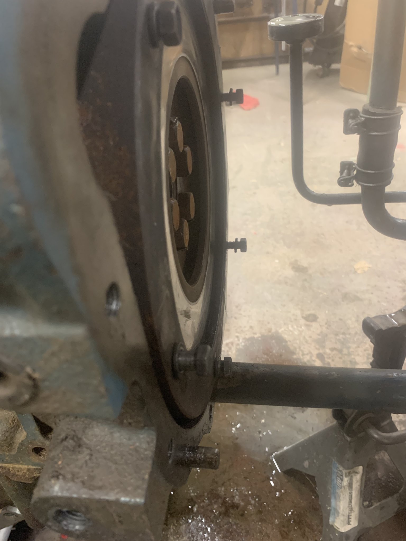

Are you absolutely sure you have the disk facing the correct direction?
33,589
8,830
Based on the wear pattern on the new pressure plate it really looks like the throw out bearing is either wrong or installed backwards (yes it's possible on some to put it on backwards).
If you have the old pressure plate, compare the wear marks.
Another very distinct possibility is that the disk hub it hitting the flywheel( like White Tiger said!) and it looks that way in the photo.

I don't think that's animal hair. It looks a lot like the fiber we cleaned out of a friend's Nova at the drag strip back in the mid-70's. He found somebody with a spare, we changed it out at the track, and he made another pass. That fiber almost filled up the bell housing!
Why is there a glob of grease on the pressure plate?

Good question - I didn't see the grease at first - up in the dark photo margin on my screen.
