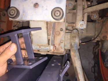

Moving on. Installing it tonight it went smooth so far, very awkward, suggest two guys to hold it while setting bolts. I am at a point where I do not know what this "H" piece is supposed to go it as there is no room for it and it will hit the seat mount. anyone have ideas.

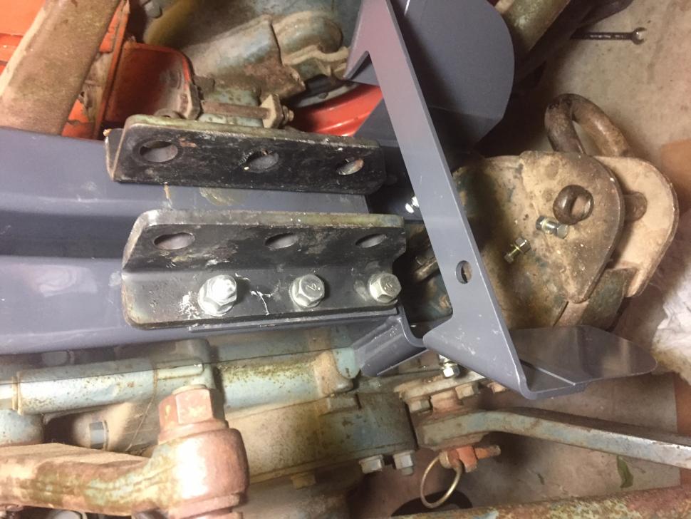

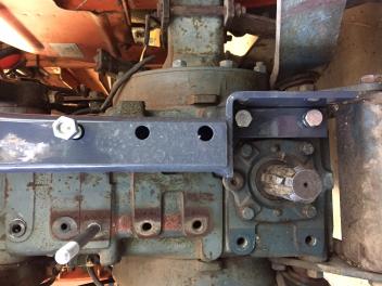

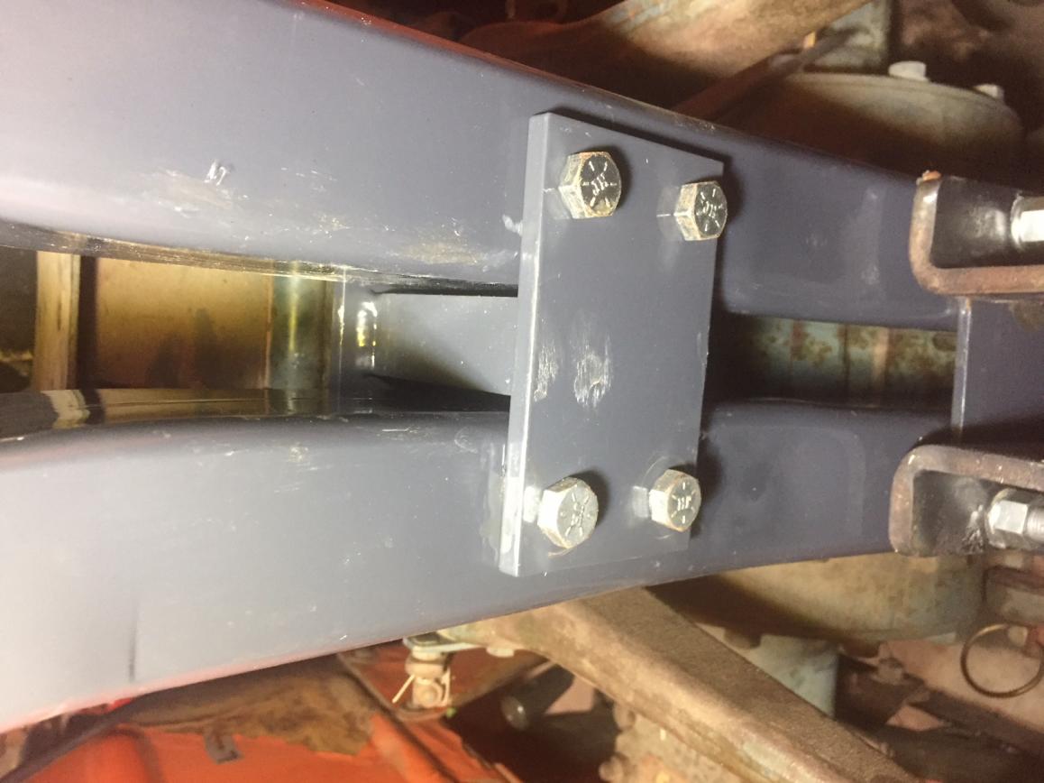

Well turns out I was making way harder than it needed to be. The H piece went between the tube and not to the frame. duh. I will say i had to undo all hte bolts to get it back in there though even thought i followed directions. ALso, suggest making some of the holes a little bigger, they werent all perfect.
