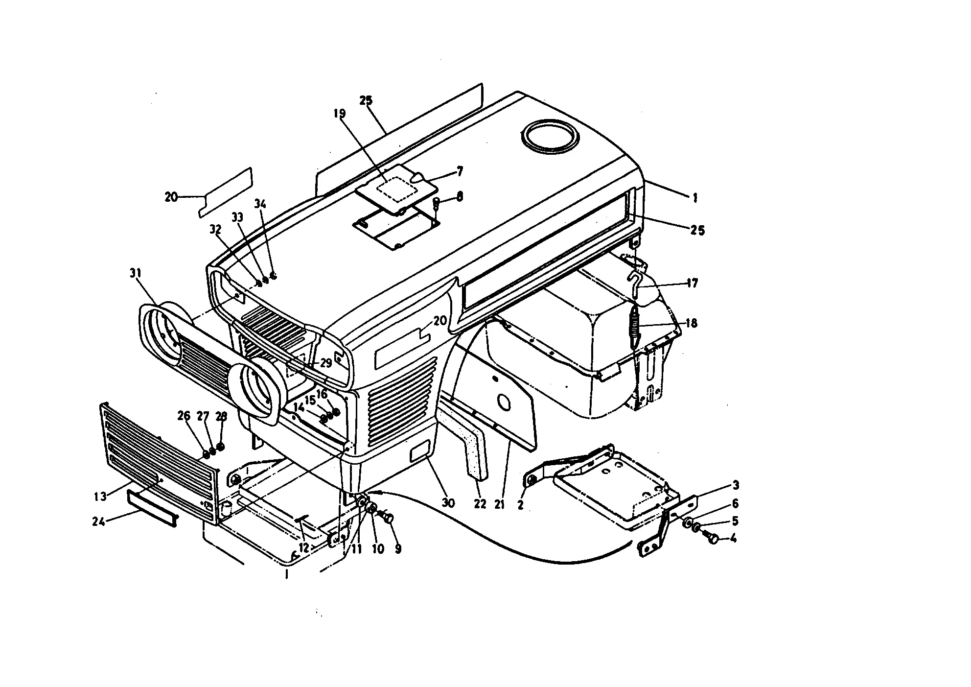

Look at the online Messicks parts catalog and see if the bolt-ups are tight and the front axle support bracket is properly assembled and not cracked or broken:
