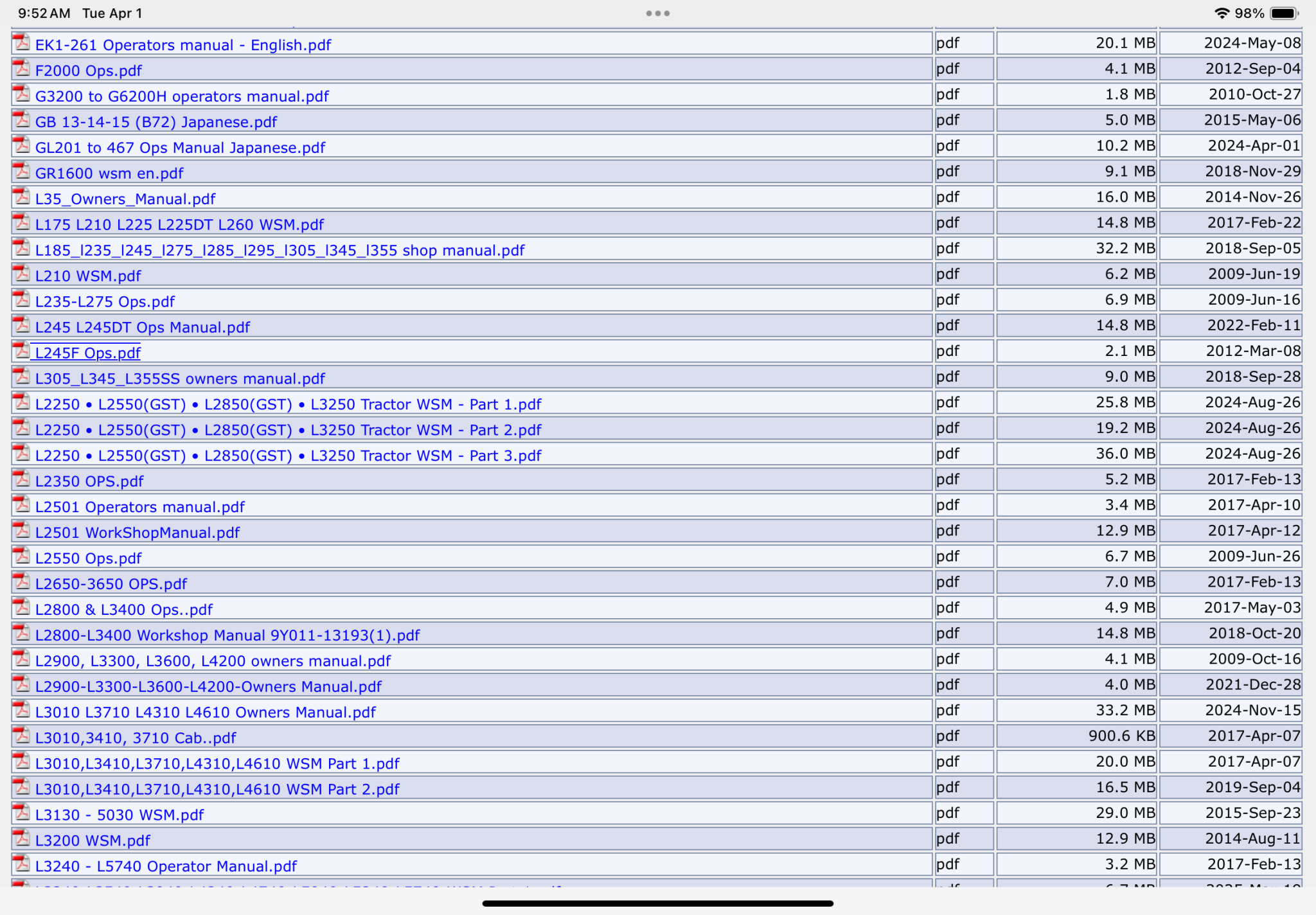

So sorry but I am unable to attach the manuals in a PM. I guess I have to send them by email…
So instead you can get them from
Pick on the tractor picture for an index like this
If you can’t get them send me an email to RussellKing at Austin dot rr dot com
