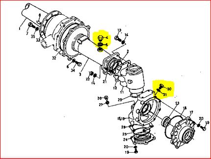

I'd like to finish this project by making sure all my fluids are replaced and up to date. I've changed everything except the front differential fluids. I've found the drain plugs for the differential and the outer drives. I've found where I fill the outer drives. I can't, however, find where I fill the main differential.

So there are only two places to put the oil? The top side on the right and the top side on the left? It calls for 1.2 qt. at in the outer drive and .8qt. in the front differential. Do I put 1.2 in the right side and .8 in the left?

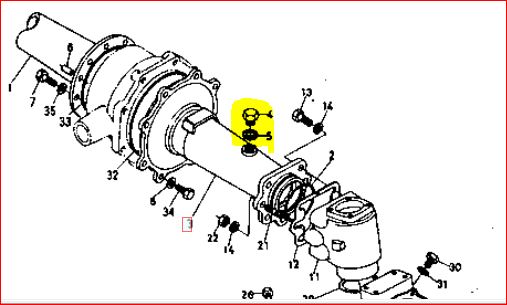

Does this help clarify things?
You put .8 quarts in the right and .8 quarts left gear case at #30
You put 1.2 quarts in at #4 (there could be 2 of them, one right one left but they both lead to the same place.)
You did drain the fluid at three places right?
Sorry I don't know what size nuts the plugs are, and they really shouldn't be very tight.

Yes, that really clarifies it. Thanks. I haven't drained anything yet. I wanted to be sure I had all the info first. Number 30 looks difficult to get to, but I'm sure I can figure it out. Thanks again for all your help. This little tractor is a beast and I'm going to be really happy having it up and running again.
