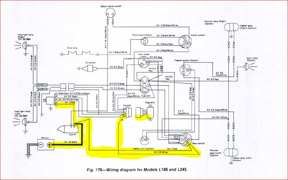

Quick way to test to be sure where to look. Disconnect the hot wire going from starter to alternator. Then meter battery.
If you still have a drain, it will drop .1 volts or so, fairly fast and steady.
If no drain after disconnecting wire, then it's in the alternator.
If you still have a drain, then you need to work your way under the dash. Could be corrosion in a pin connector, at the key switch, or relay under dash hanging up slightly.

Well, the problem continues. Installed a new alternator two days ago. Charged the battery overnight. Alternator seemed good, put out 14+ volts. Let tractor sit overnight with key out of switch. Had 1 volt in the morning. Relays under the dash have been mentioned, what relays are under the dash of a L245??
Any input is appreciated...thanks

I see one other part that you are discounting, the voltage regulator, that has constant power too, so it could be a drain.
Just disconnect it and see if your drain disappears. ;)
