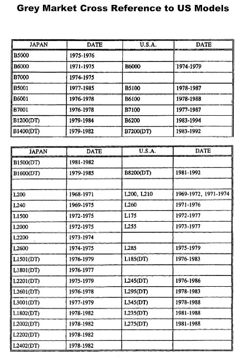

Hello, new here. I have a opportunity to buy a L240 that has been sitting for a while. Local dealer said was gray market. It’s going to need some parts like ignition switch and heaters to start. Anyone with one of these and maybe a USA model number equivalent? Thanks

Although a chart has been provided every part listed for the given US model may not fit the Japanese version. There may be some differences. You should be able to read the numbers off the glow plugs and find exact replacements, they are probably NGK. Be sure the ignition switch is actually bad. They can approach $100 though you can do a work around with a regular ignition switch and a separate button for the glow plugs.
