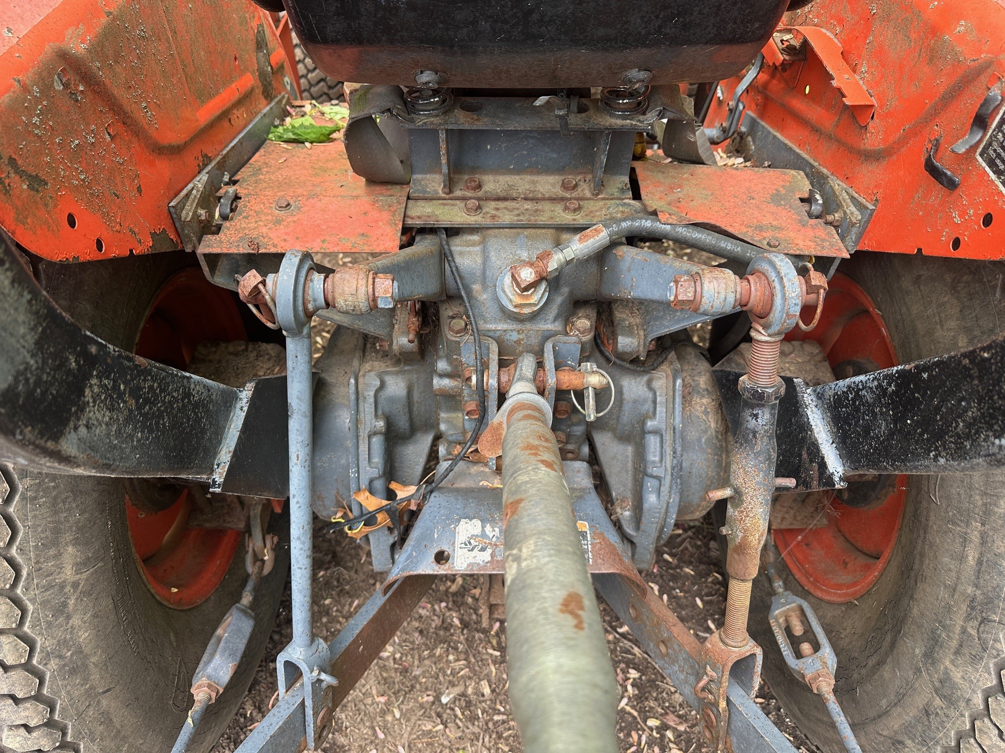

The two hoses under the seat on the left side are pressure out and pressure return. Put a coupler on the pressure return port of that block and thats your hookup for the hoe. Use the hose coming from the loader valve to supply the hoe and connect the return on the hoe to the block. When the hoe is not mounted connect the hose to the block. EZ-PZ

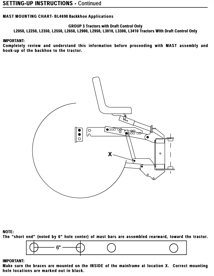

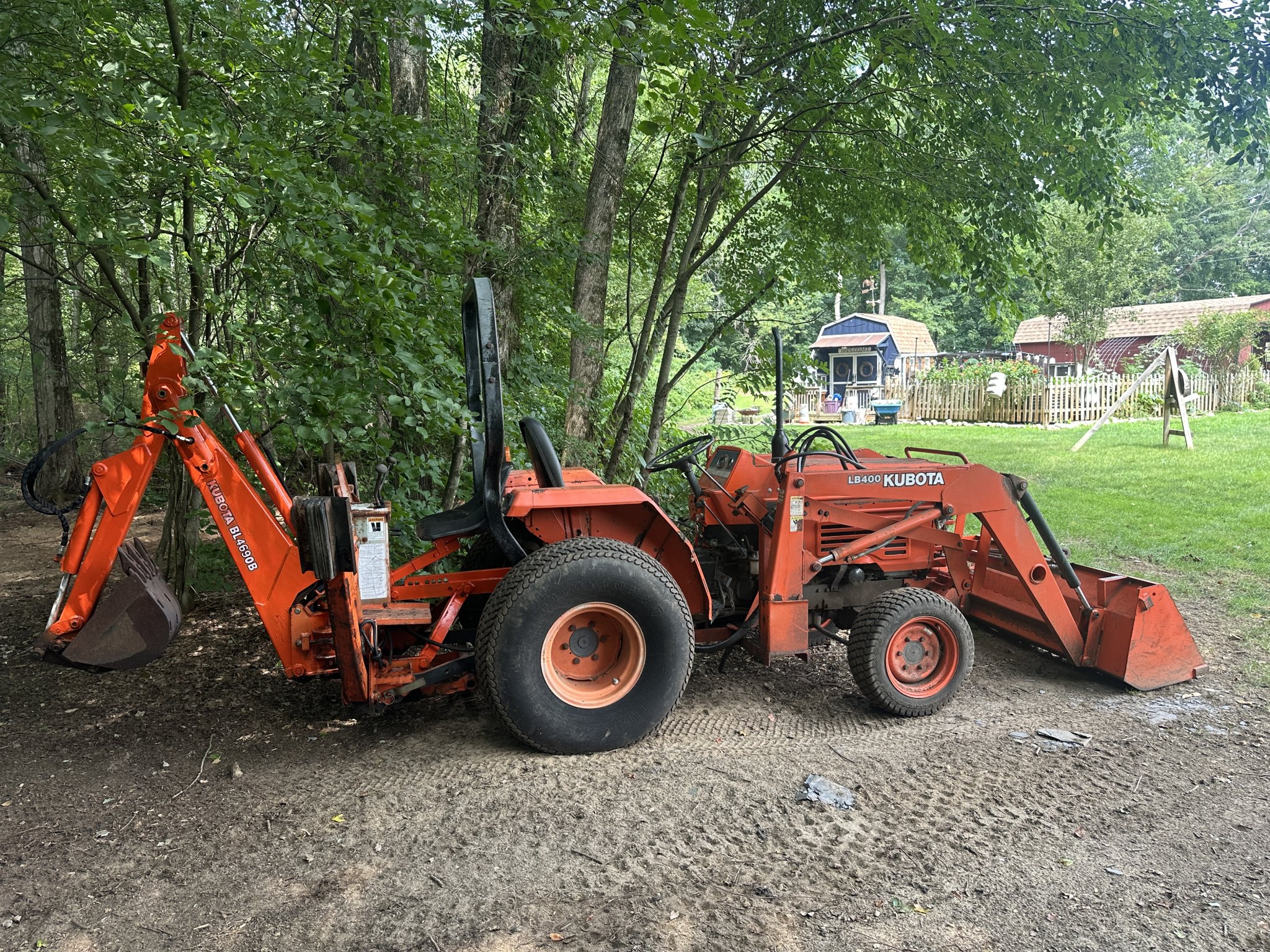

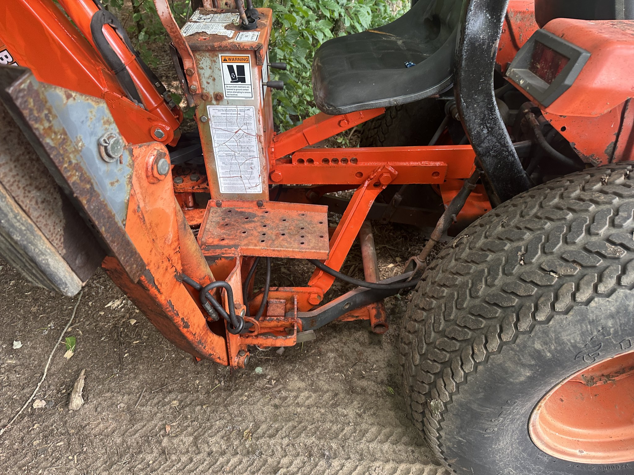

a little progress photo, kubota2.jpg i got the backhoe partially on but cannot seem to get the mid link bar to line up with any of the supplied holes. i did install the heavy duty bracket. this was with the top link disconnected just to get it out of my driveway for the day. haven't messed with the hydro lines yet.

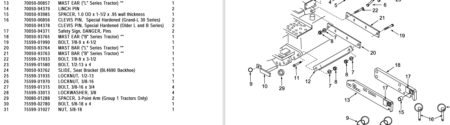

The backhoe does have different mounting components with different mounting holes for the B series and the L series tractors. I ran into this issue when I had gotten mine.
This is the mounting holes for the L2350:

Here are the part numbers for the different mounts:

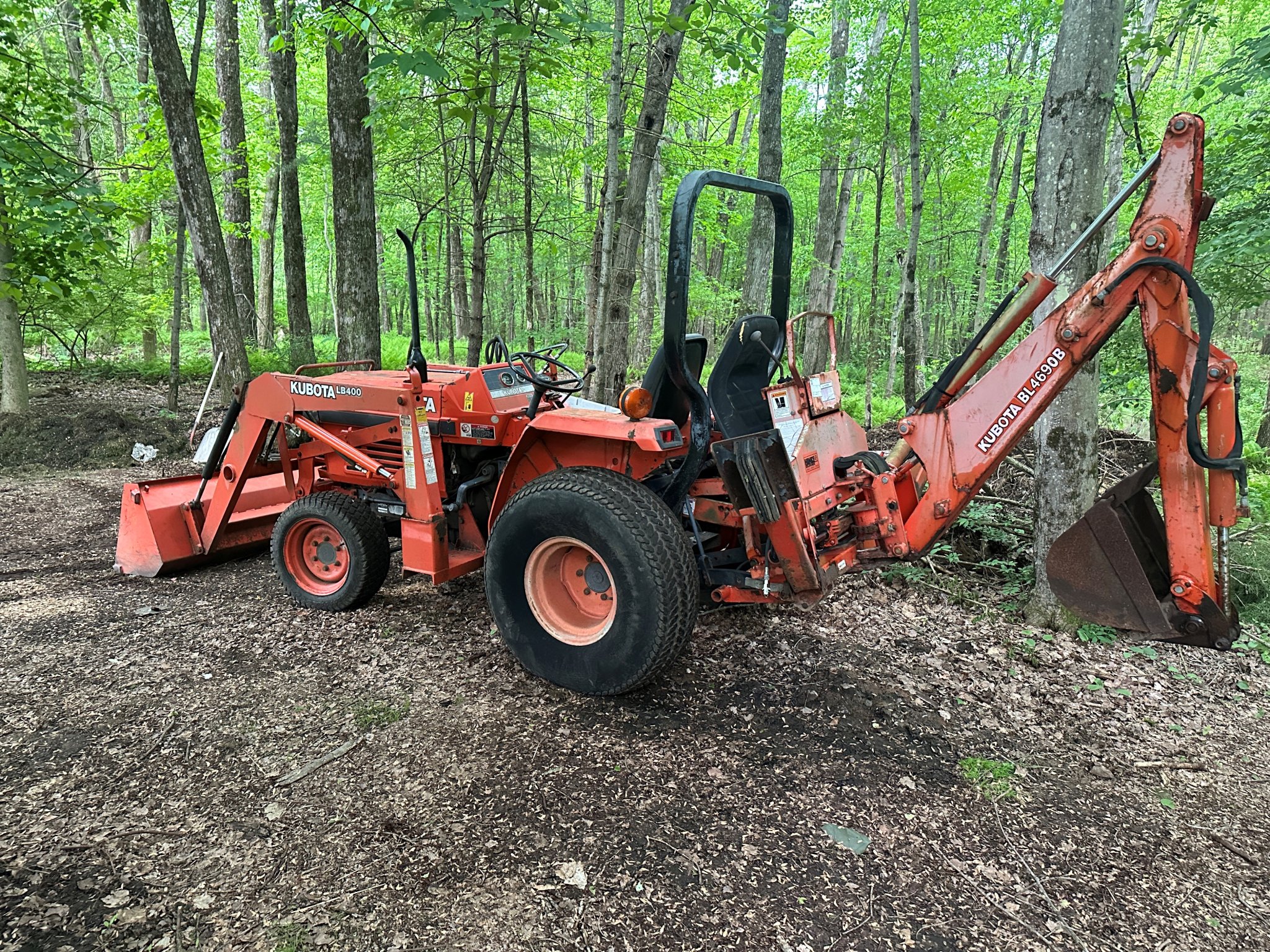

So she’s up and running. Had a few lines that were leaking and I have to reseal a ram. Very happy with the power and the speed running on the stock hydros. Thank you to everyone that helped with the insight.
