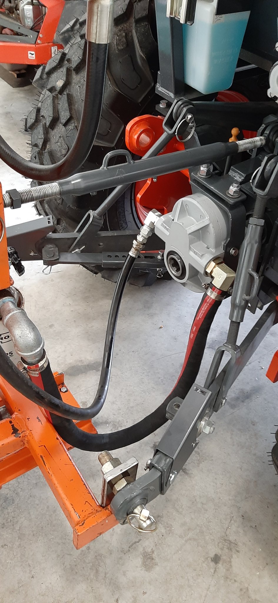

Here is the bracket that I made to hold my pumps. One on my splitter and the other on my BH. I can adjust the nuts on top so that there is minimal downward weight on the pto extension. The upper part of the bracket has a sleeve that uses the lower pin location of the 3ph bracket. The guard around the pto also has to be removed. My BH is a BH77 that I converted from tractor hydraulics to pto driven. I used a 6.8 gpm pump that was readily available.

do you know what i would need for a shaft extension if i go the pto route? not much room at all back there..also how do i know if i can go to my factory hydraulics? like where do i tap in?
You can get a slip on PTO extensiom at any tractor supply for roughly $25.
You can tap into tractor hydraulics at the loader valve.

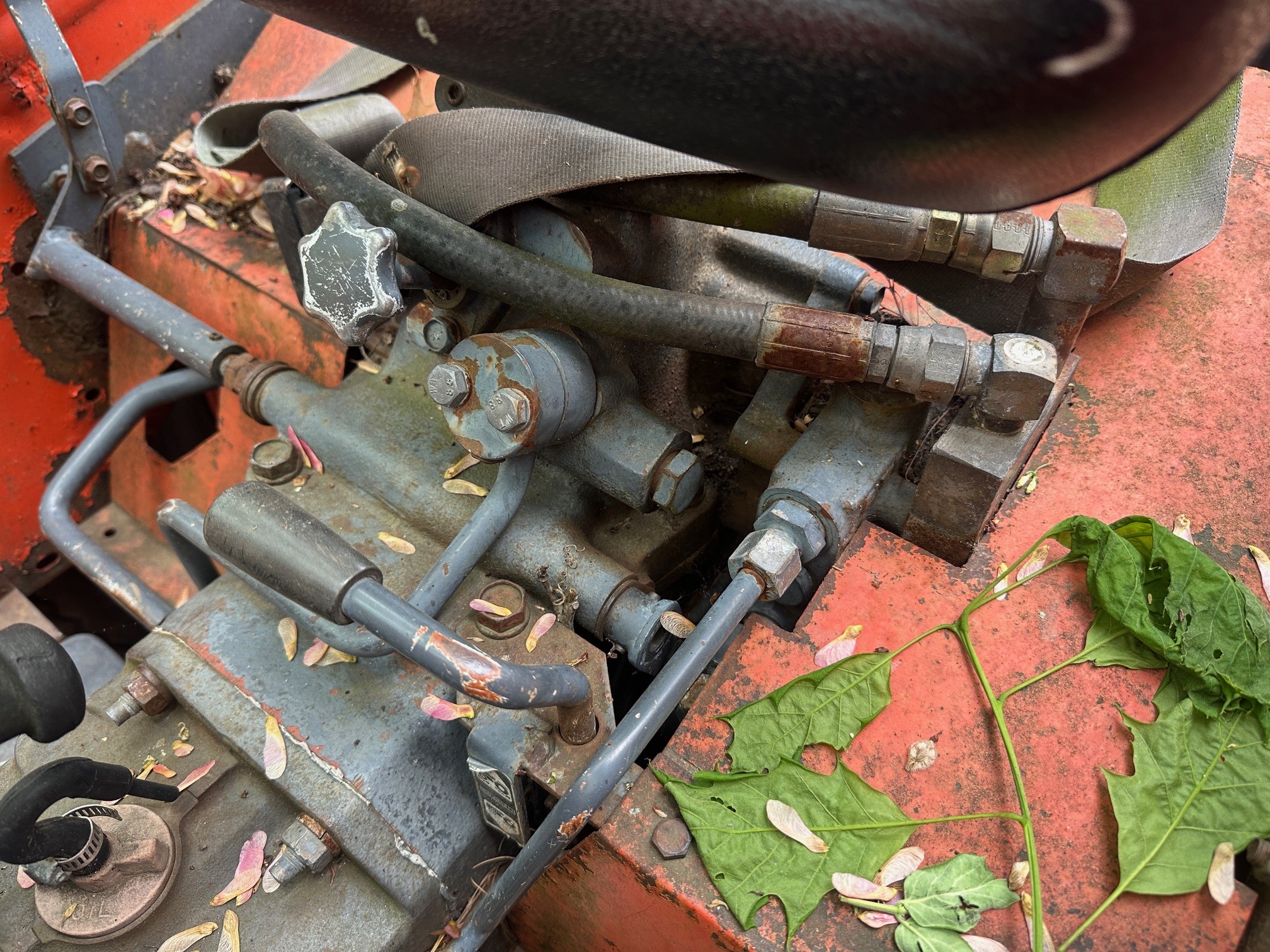

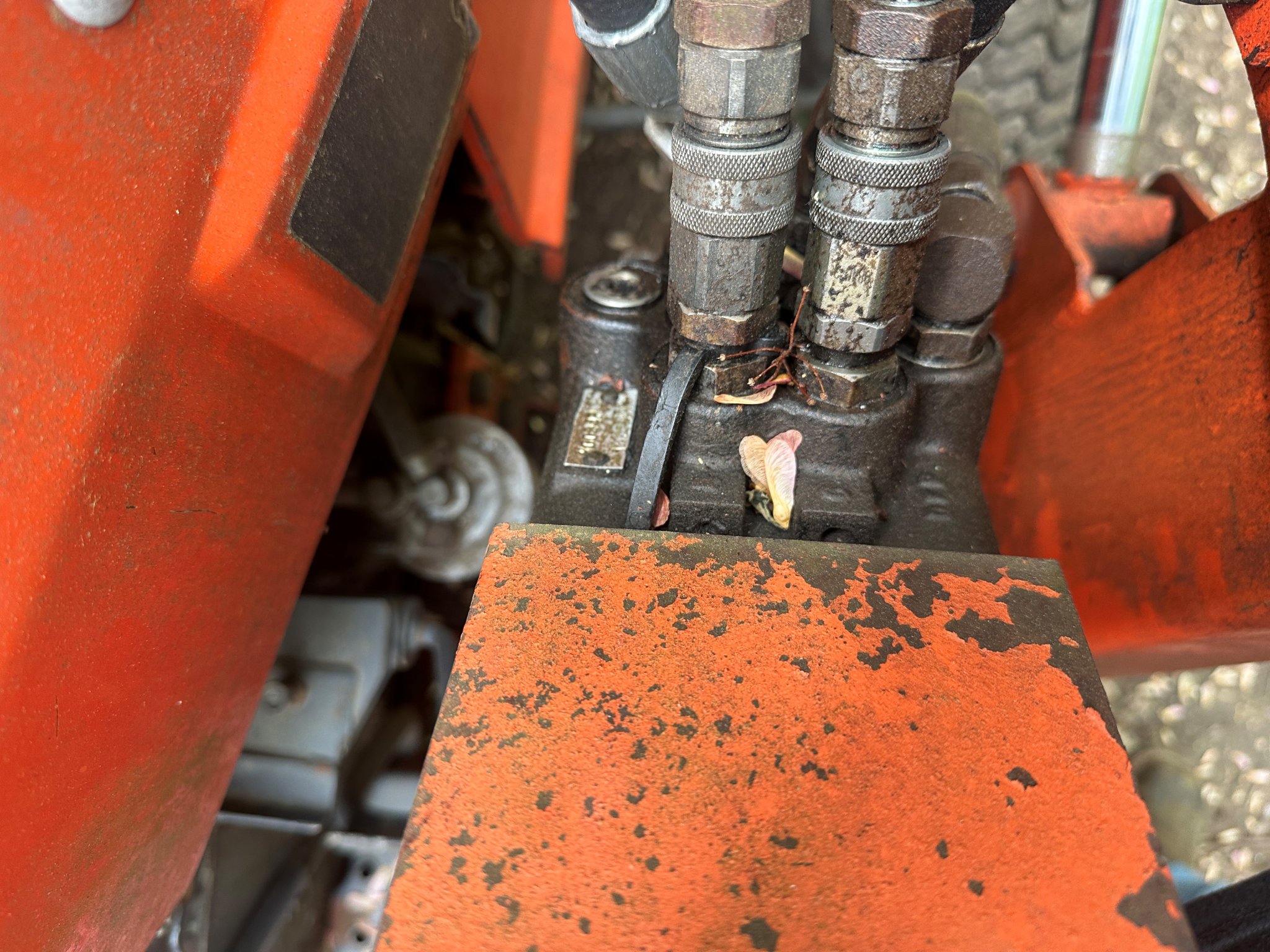

It may not be outpur per se. Where is the hydraulic outlet for your loader?
