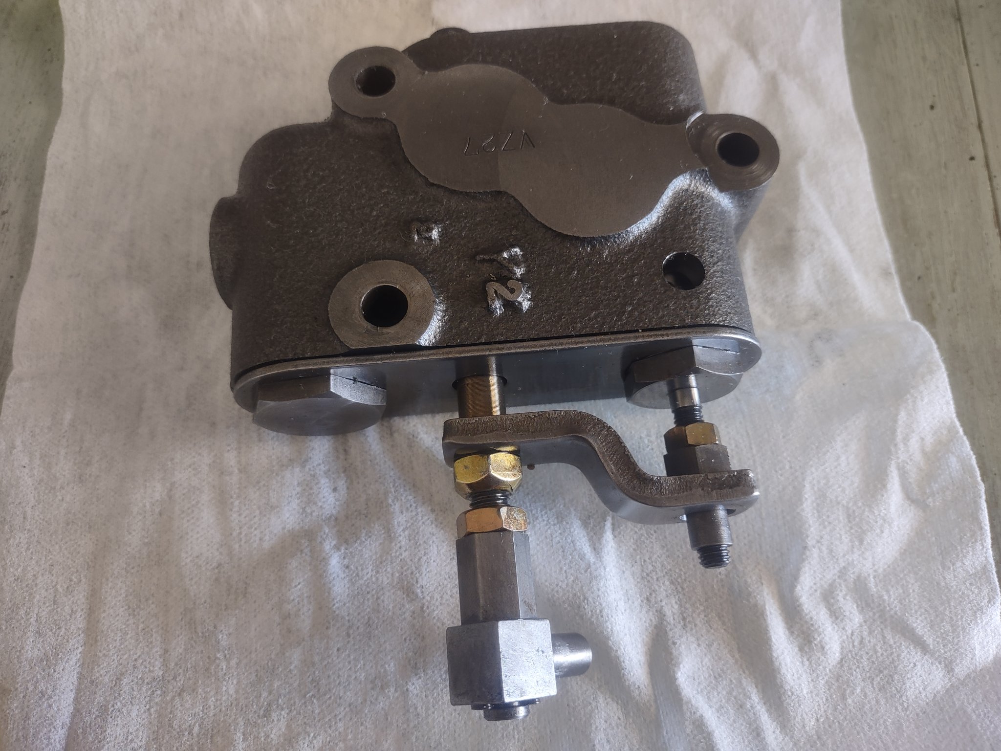

The bolts that hold the plate are shouldered. The plate will have a slight amount of movement in it. I have a good used valve if you need one.

Watching it again I don't like the slop in this connection:
I'm pretty sure it's excessive.
I agree. I think the spring on that rod, in the valve body, is supposed to keep the slack out by keeping the connection in tension. Either that rod adjustment needs to be shortened, or something in the valve is not right.
I'm curious, did the replacement valve take the movement out of that connection?
Yes it did, not as loose. After I get the tractor put back together and adjusted I'll take the valve apart and rebuild it. I'll post the results.

Got it all back together with a replacement valve provided by Kubotaguy and things are working.
My thanks to all that helped along the way. I definitely have a better understanding of how the valve works, replacement and adjusting.
