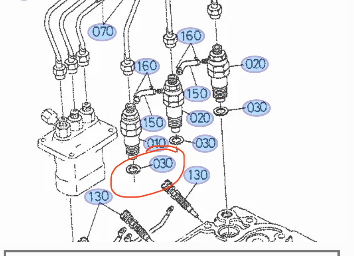

Are the copper washers #30 a standard size? Can I get them off the shelf from (don’t kill me) harbor freight copper washer pack?
Also, do I need to replace #50 washers?
And for the life of me…I’m not seeing a #60 in my injector or I don’t know what I am looking at?

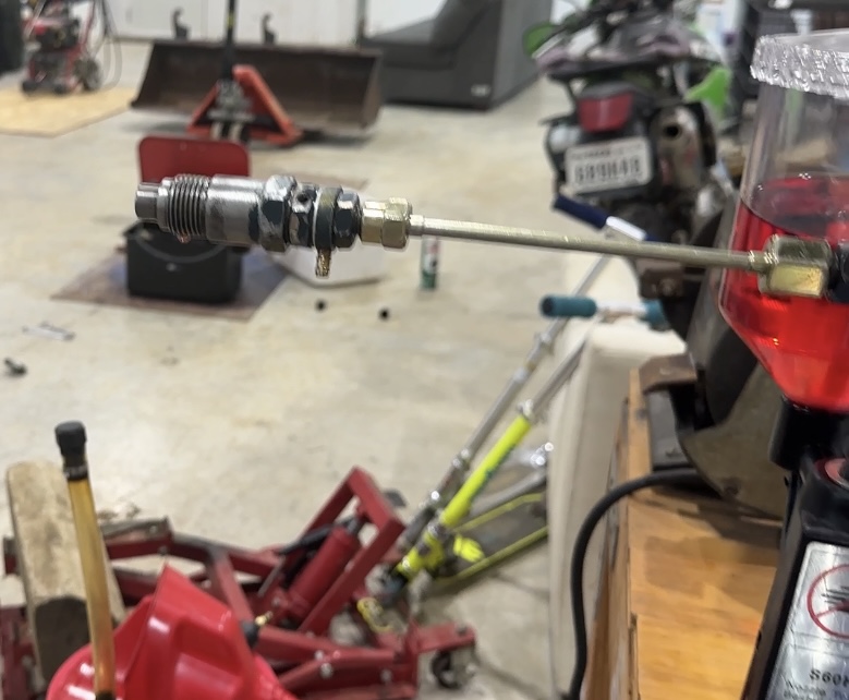

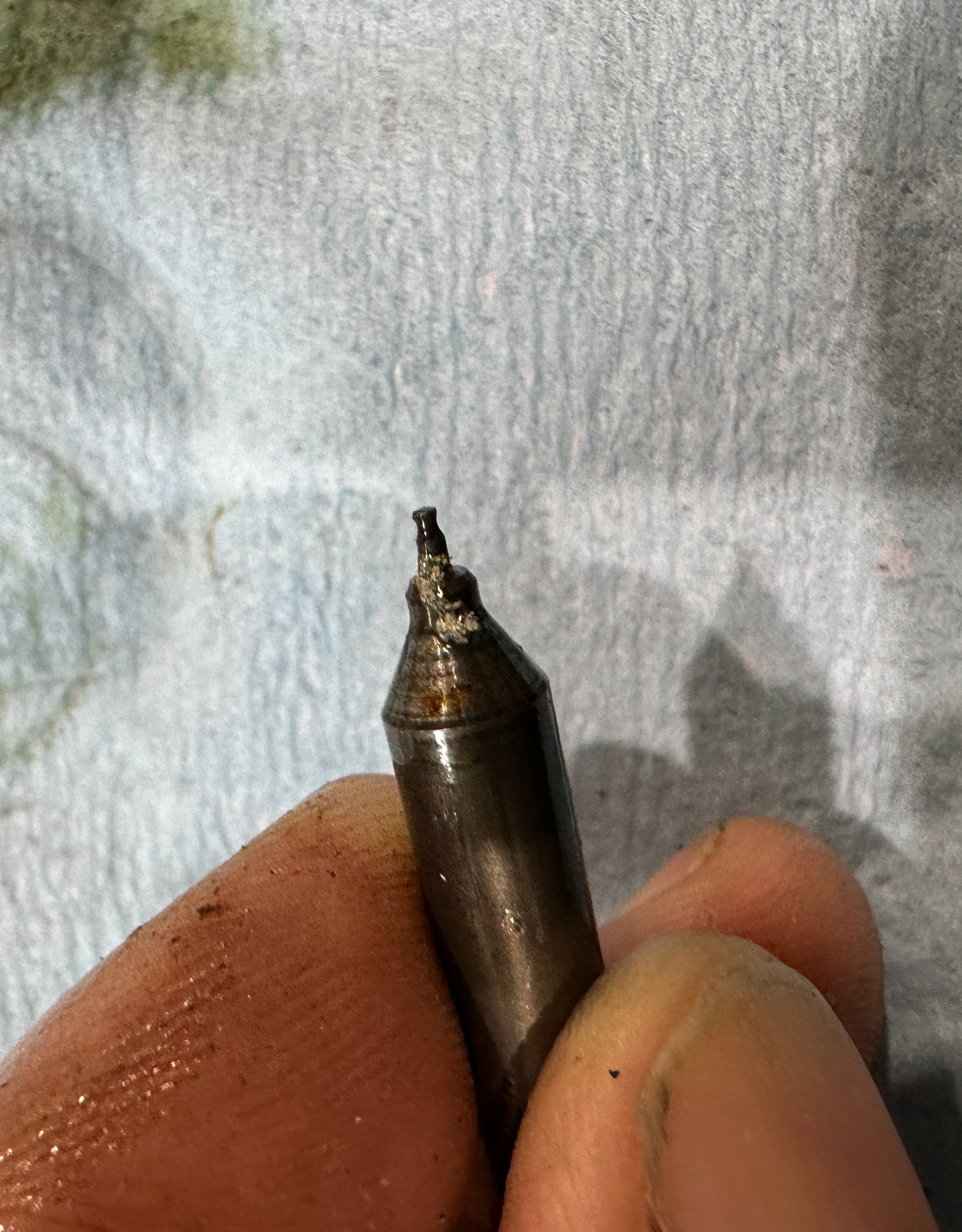

Well, I rigged up the injector lines and tested the injectors before I cranked them down after the cleaning and rebuild….glad I didn’t just throw them in!
I have one that needs to be taken back apart and inspected.
Really neat being able to watch them fire! I have pretty good spray patterns on the other 2. I took slow mow video which really helped seeing the patterns.
I’ll take apart the one that’s missing and see if it possibly got blocked.

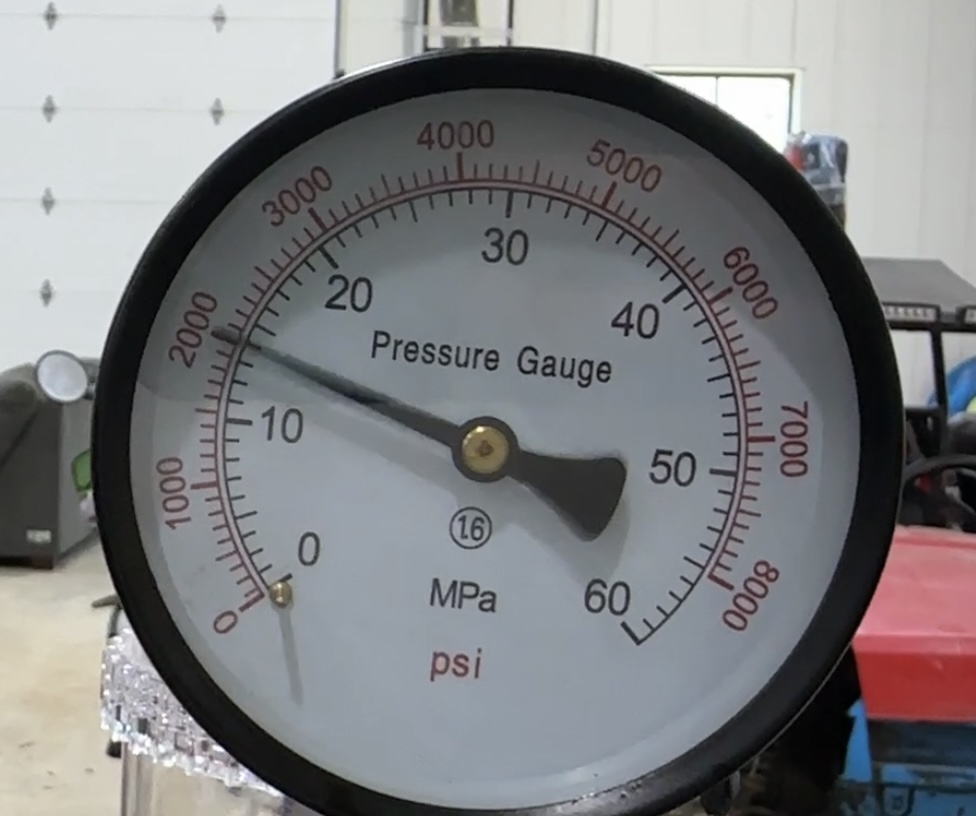

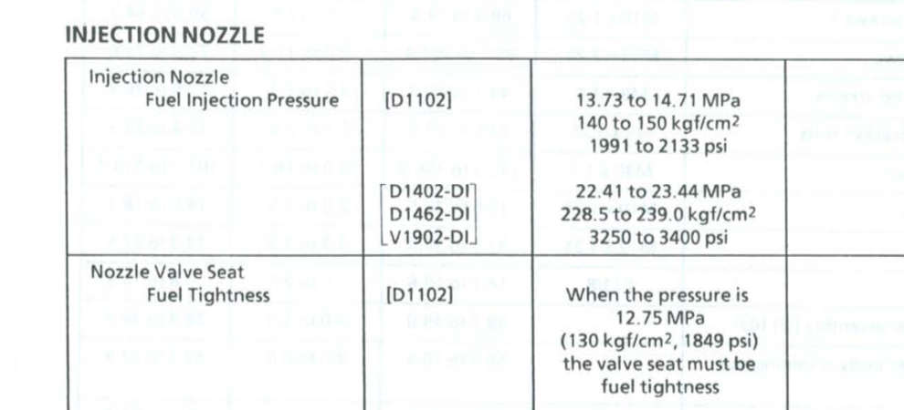

What pressure do you have them set to pop off at? It is equally as important as the spray pattern.

Well there’s the problem right there!
I’ll be putting it back together and let’s see what we get. I’m gonna test all of them on pop off pressure and post up results.

Tested the one injector that was not firing with the new shim I got from Kubota. It would only go up to 1400psi.
Put the old shim back in and got it right up to 2000psi. Perfectly in specs.
The new shim has a hole in it so it sits flat inside the injector. The old shim does not have a hole in the center and is raised in the injector so it’s providing more compression on the spring thus raising the pressure. Interesting how it all works! Spray pattern looks great as well! 👍
