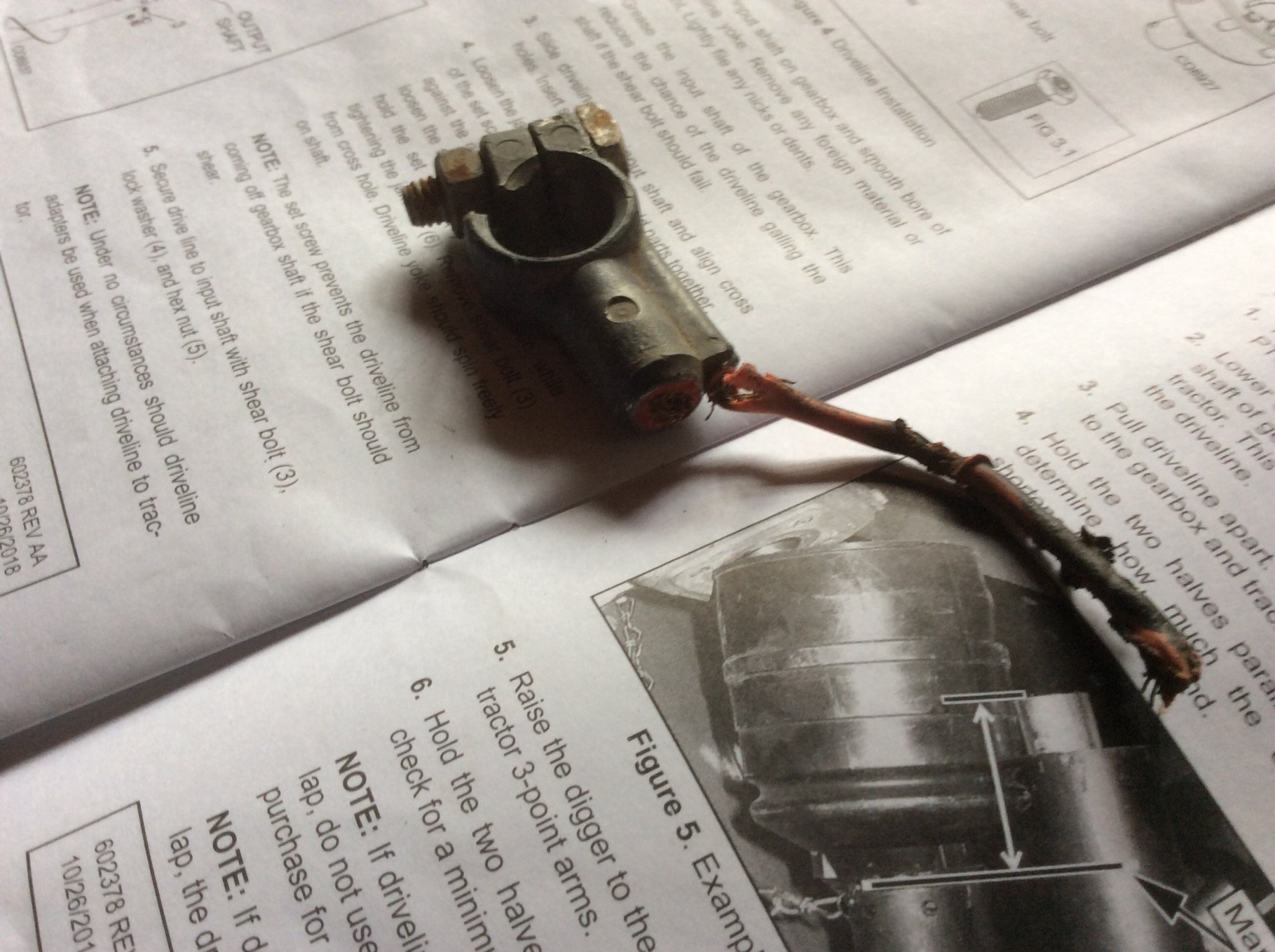

My positive battery cable post harness broke - it had an extra small red wired on it but I’ve not been able to back and figure out where that wire went or was supposed to go. I could not find a replacement so I just replaced with a single harness that just has the one large cable wire; Everything seems to work - the tractor overhears after a coup,e hours or hard bush hogging then won’t start for an hour, then starts right up once cool.
So my questions are: what is that extra wire and is it just incorporated into the main cable?

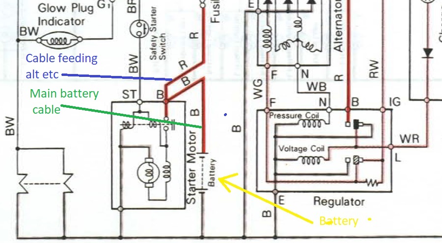

I have attached the wiring diagram.

The battery is not depicted in that diagram, but the regulator is energized whenever the alternator is powered thru the ign switch, so the point you are attempting to make is not valid if I‘m reading it correctly Dave.
Excitor: Many battery cables have an additional short lead so that accessories may be “hot wired” to the positive battery post. Not all tractors use it. If yours doesn’t need it...no harm is done in replacing it with one that doesn’t have it.
I cannot speak for your specific tractor but I have worked on 100s of electrical systems.
*) The BIG red wire goes directly to the starter. (no fuse) and is ONLY used for starting the engine.
*) The smaller red wire usually has a fuse and feeds the rest of the electrical system. (lights, charging the battery...etc)
The battery IS depicted in the wiring diagram if you look closely. My original comments are correct.
I have taken a section of the wiring diagram and drew a line to the battery.

Thanks, Dave. (That is the most diminutive depiction of a battery I’ve ever seen.)
The comments I made earlier still seem valid... the alternator and regulator are both powered by the same BIG red positive battery lead.
I agree when I first looked it was like I was back in a physics class.... not clear.
My point is that with the alternator having an external regulator, there is nothing to turn on the alternator absent a connection to the battery which is what the owner has done by omitting the red wire connection at the battery,
The battery, regulator and alternator + the tractor's wiring all depend upon the not connected red wire. At least the fusible link will never blow :)

Dave, that’s not the way I read it. Where do you see a small, separate connection to the battery for the regulator and other items?
You must recognize that the wiring diagrams are not exact representations of where wires actually are both on the tractor and within the harness. They are a schematic representation (aka a sketch) to help explain and demonstrate what connects to what.
The connecting of the two wires is shown taking place at the opposite end of the main battery cable to what the owner sees but, from a design and maintenance point of view those two circuits are connected and further nothing gets into the tractor electrical system without passing through the fusible link save and except the current between the battery and starter.
When you move to more involved wiring say in an industrial setting, you will have both a ladder wiring diagram and a schematic diagram.
Neither is intended for production of the harness but rather for "in the field," maintenance and troubleshooting.
The wiring diagram Kubota production engineers would hand to the production floor would look nothing like what is in the WSM.
This is another wiring diagram from the same manual. It looks different but in reality the wire interconnections are the same.

There will not be any FACTORY small wire to the battery, the only battery small wire connectors are on the Starter lug where they will attach to the large cable via a fuse or fusible link.
Most likely the wire is some "fix" or "add on" like lights.

You guys are great. This is my original cable when I bought the L2350.
You are all correct the main cable goes to the starter, but a second red wire is screwed to that cable, that goes to a coupling with a blue wire 1 inch loop- then proceeds on as a red wire into the rest of the electrical system.
Sounds like consensus is the wire off the original cable doesn’t matter.

Does the wire loop you mention look like this?
If it does then this is the fusible link aka fuse that feeds the entire tractor. It is surprising if your link is not in the system that the tractor starts and runs.
The blue wire loop is the fusible link which protects the wiring.
The side of the fusible link which does not go into the electrical harness - how is that connected to the starter where the big wire from the battery is attached?
The link looks exactly like the picture but blue wire - it is screwed to the same post as the starter.
