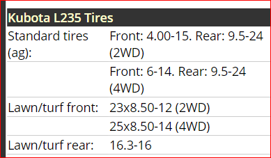

I have a L235. I put 11.2-24 ag tires on the back. I was wondering what size front tired do I need? AND where can I get the rims and tire. The rear ag tires and rims were super hard to find. Thanks

4wd or 2wd? Assuming 4wd?
Scottjette
L235
Jun 29, 2021
it is 4 wheel drive. The manual states it can also handle 11.2-24 rear ag tires. And as i stated previously, it was superrrrrrrrrrrrrrrrrrrrrrrrrrr hard to find them, the rims are the hard part to find, not the tires. Now, i am searching for the front, RIMS, i know i can get the tires. i see i need 6-14 fronts, but i need to find somebody who has the rims to fit my tractor. it is a 6 hole pattern, with a 5 1/4 pilot hole, and it is 6 3/4" from stud to stud.
