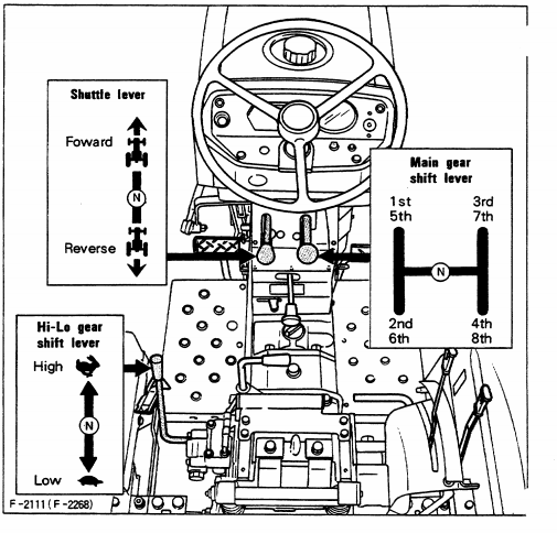

Hi guys does anyone know where I can find the plate that tell me what gear I’m in on a L235. I bought the tractor and I’m unable to make out the gear numbers being that they are faded beyond recognition. I looked on eBay and several tractor part websites with no luck. If anything can some one with a L235 take a picture and post it so I can label mine. Thanks in advance
10,977
2,831
Does this help?

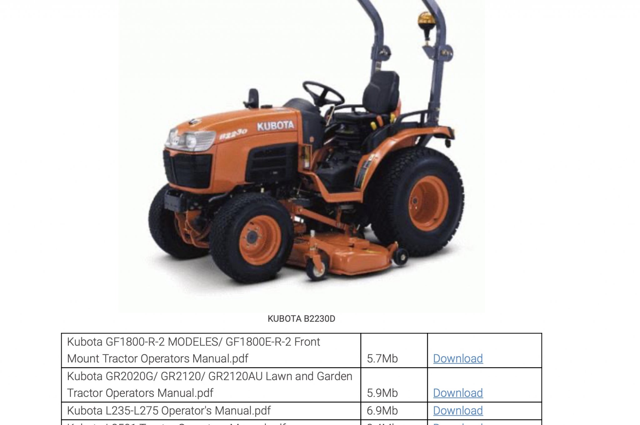

Also, if you don't have the operators manual you can download it (free) from the following link: CLICK HERE FOR LINK
Scroll down on that page until you see it as shown below:
